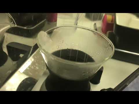

              • Testing 5 hole baskets for pour overs
                I'm working with Scott Rao to try to improve our espresso machines' ability to make pour over coffee. These custom made portafilter baskets are meant to have controllable pressure, in order for Scott to have control over agitation of the grounds. We've made 3 different hole sizes for Scott to try out.
                My hunch is that the holes could stand to go a bit larger. We calibrated these holes for 4 bar of pressure, so we'd be able to go up or down. However, now that I have them in hand and I can test, I think larger holes would be better, because a substantial jet is formed at just 1 bar.
                I told Rao this via email, and suggested that he might want to enlarge the holes with a sewing needle.
                These baskets are just our first attempt. There will likely be many more revisions before we're happy.
                Coffee ground turbulence during a pour over is super important. The famous "Rao V60 pour over” https://www.youtube.com/watch?v=c0Qe_ASxfNM addresses this, for manual pour-overs.
                The question is: can the optimum turbulence be mechanized with our pressure and flow controlled espresso machine, and a bit of specialized hardware? We don't know yet.

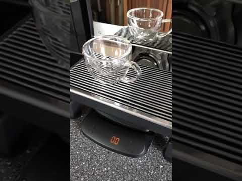

                      • Weighing from below
                        I knew that it was possible to place the bluetooth scale we sell under the drip tray, but the fit wasn't right, and it didn't work that well. These problems seem to now have been resolved by the Decent user community.
                        The advantage of having the scale underneath is that you now have access to the entire drip tray, and you don't have worry about spilling coffee on your scale. It's invisible, and out of the way. You can now also USB power your scale, since the USB cable will not be in the way.
                        Decent customer Michel Wyss did the first draft of an idea, and shared his drawing as a STEP file. He replaced the top of the skale with his own design, which was a bit taller, and sized to fit the ceramic drip tray correctly.
                        Steffen Lav revised this design, printed it and posted this video today on youtube of it working:
                        Anyone with one of our "skales" and a decent espresso machine can download the shared STEP file and have it printed inexpensively, locally, with a service such as https://www.3dhubs.com/
                        I'll be testing this myself in a few days as well.
