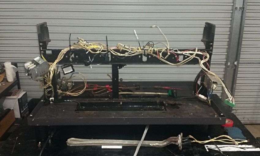

    Not much left now on the strip down and the clean continues. From the wiring to the condition of the boilers, I am thinking this old girl has had a hard life.
    Can anyone recommend a good method for descaling the lines and boilers now that they are out?

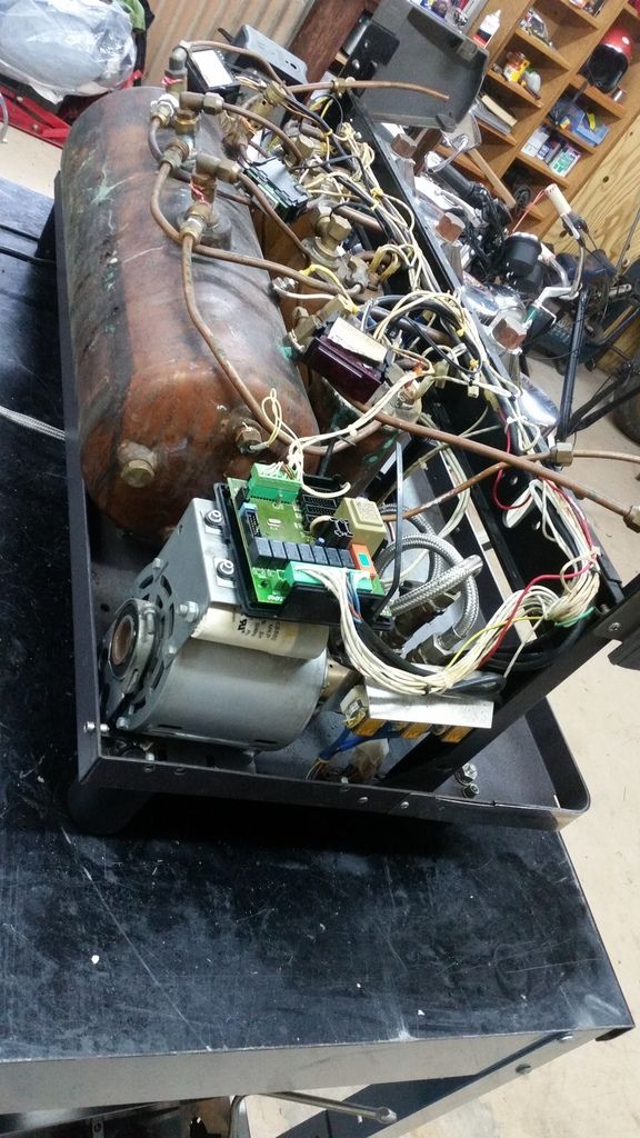

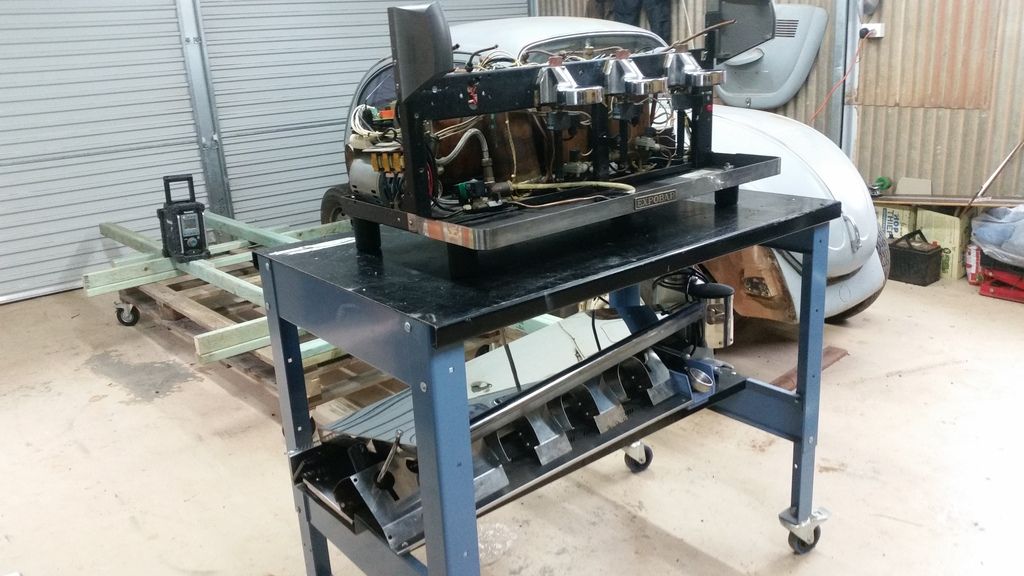

    Some photos of the progress, from a few part manufacturers dates inside the machine I am guessing its around an 07 model.
