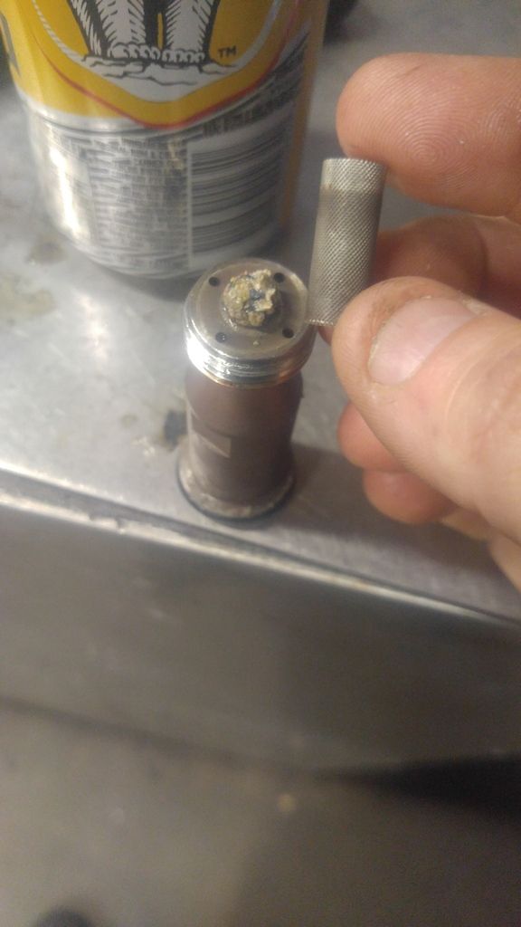

  • bowser
    This screws into the top of the group head, the main nut is 36mm and the machined flats can be seen on the valve body. Seperate these and the little Jet and screen is inside

    Sorted, thanks to the help of a forum member who steered me in the right direction, much appreciated.
    found the jet in the top mushroom bit blocked up. I pulled this out yesterday but didn't strip it this far.
    What it now looks like, water flow is so much better, 30ml in about 4 seconds

    True, but with the ECM machines it can be a little less obvious how to get to it, they don't have the usual 22mm nut on top of the mushroom, instead you have to separate the two halves of the mushroom using the upper 36mm nut and the lower half which has 19mm flats machined into it

    The mushroom valve should always be the first thing that gets checked if you suspect there's a blockage. If there's scale present this is where you'll see it most easily. If the group head is clean then your problem is elsewhere.

    Wooohooo , glad to be of service... :-) Hopefully you tried that option before my other suggestion ? (checking the water valve mesh filter) ?
    yeah didn't bother with the other one after I found this. It was easier to get to. Thanks again
