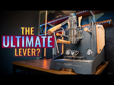

          Not quite sure I understand you here. Slim Jim's spring pressure adjustment is indicated as being very small and intended to equalise springs between groups for consistency rather than on-the-fly brew control.
          Now you can probably assist or retard the lever on the fly, but you can do that on the Nurri too (and my other LSM lever, probably other levers as well). I think I have a video somewhere I'll upload if I can find it.
          Nurri you can change the preinfusion pressure on the fly with the new dial that Primacog has, if you really want. Slim Jim seems to be adjustable only with machine apart.
          Edit: video added

                Great video tx.
              • Caffeinator
                Caffeinator commented
                Editing a comment
                Really good watch and like Tom's review, pretty accurate IMHO.
            • #68
              I agree with most of his observations though for me, I would disagree over his view that it takes force to pull the lever - the nurri lever is really easy to pull compared to an izzo for example. Also I don't really know why it is so important to steam at the same time as pulling rhe shot- I always extract the coffee first before steaming the milk as I want to focus on the coffee and I don't think my coffee has suffered. In any event if that is an issue, just stick the steam wand joystick down to keep the steam on without stopping and use that hand to then pull the paddle to end the shot, and releasing the paddle to turn of the joystick and then returning to pull the paddle won't harm the shot anyway. Furthermore there are advantages to the left paddle not engaging and staying open like a pump machine solenoid valve because it means the left paddle is infinitely variable depending on how long one wants to leave the valve open - which enable the paddle to be used for other purposes also.
              I do agree on his preference for the elapsed time reading on the shot timer to last a little longer before disappearing though.
