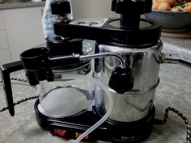

  • ddhytz
    Originally posted by mulquemi View Post
    Dear Coffee lovers,
    Acquired this old Breville espresso in absolute perfect order however,I don't know a thing about the correct operation,I need to know all that's available to get this oldie working sweetly,long shot perhaps,is there anyone who can provide some knowledge please,perhaps you have used one or have a book!
    This machine is very much similar to Bellman CXE-25 except the power switch and steam indicator are on the opposite side.
    You can find manual for Bellman CXE-25 on the internet.
  • mulquemi
    deegee,
    Thanks for your information,yes,your machine works identically,a good concept and very little that can break down and not difficult to work after all.
    Appreciate your reply
    Thanks

  • deegee
    G'day Mick, I have a Bellman CX-25 P which is similar in some respects. It is a stove-top unit, not electric, but otherwise looks a lot like yours.
    There are some video clips on you tube about how to get the best results from a Bellman. The one which I found helpful is called "proper use of a Bellman" or something like that.
    I bought mine for camping/traveling because it can be used on a portable gas stove. It's not espresso, but with fresh beans it makes pretty good coffee. I can get a little bit of crema by opening the valve slowly and just enough to get a steady flow.
    It gives quite good steam for making caps or lattes too.
    Cheers, Deegee.

    started a topic Breville Espresso TE 101 information needed!
    Dear Coffee lovers,
    Any and all helpful clues are appreciated.
    Much appreciated
    Mick
