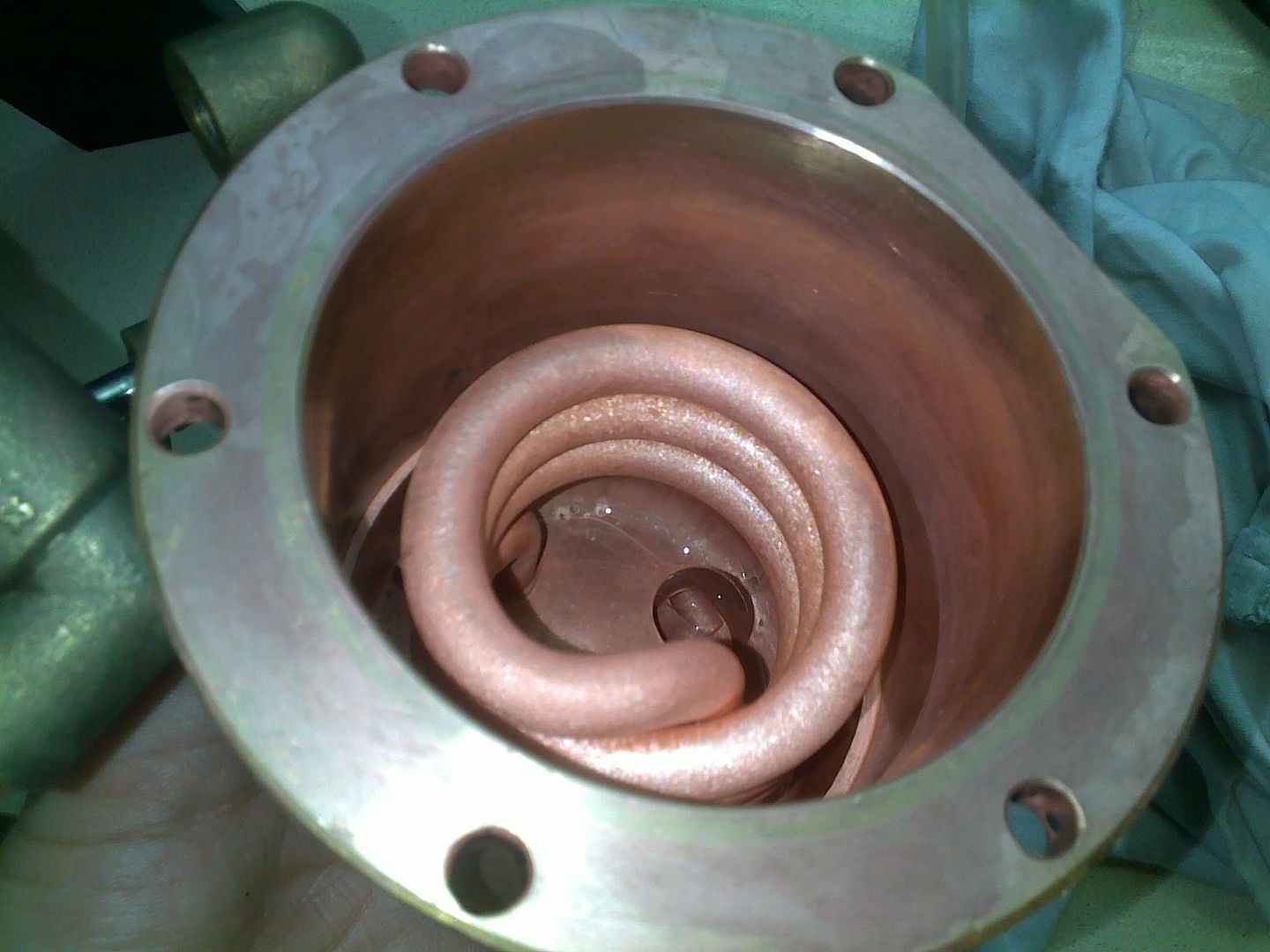

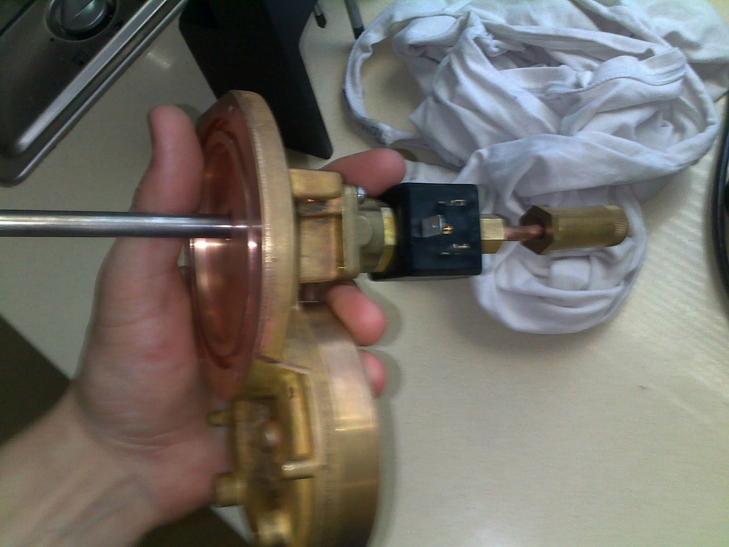

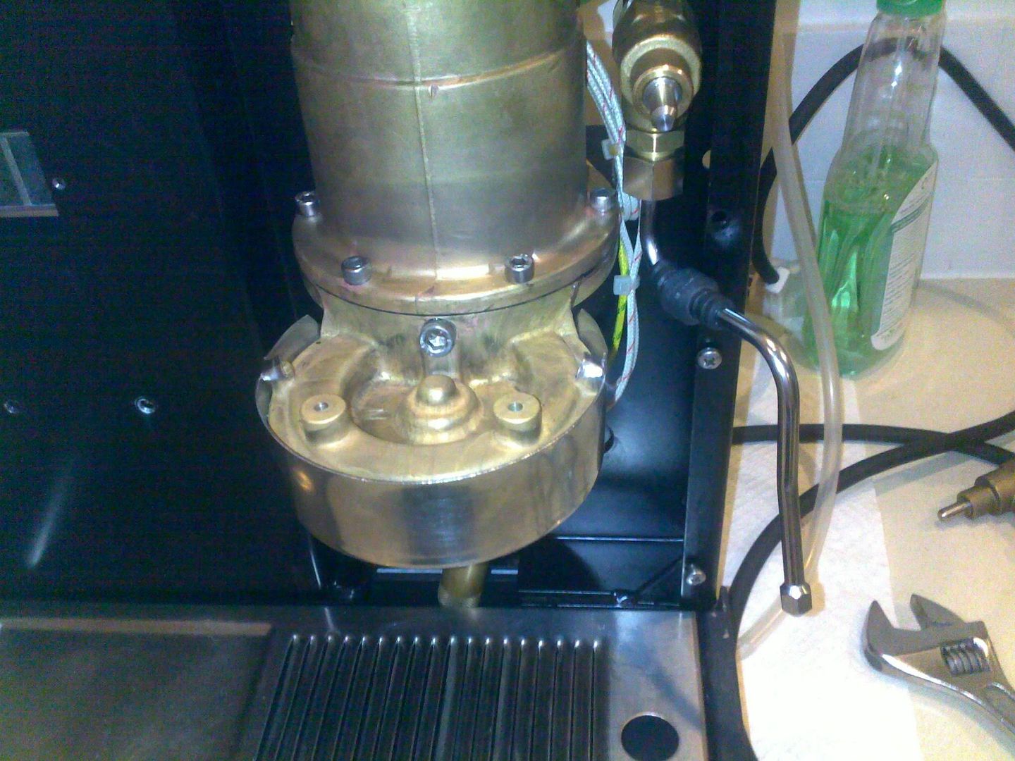

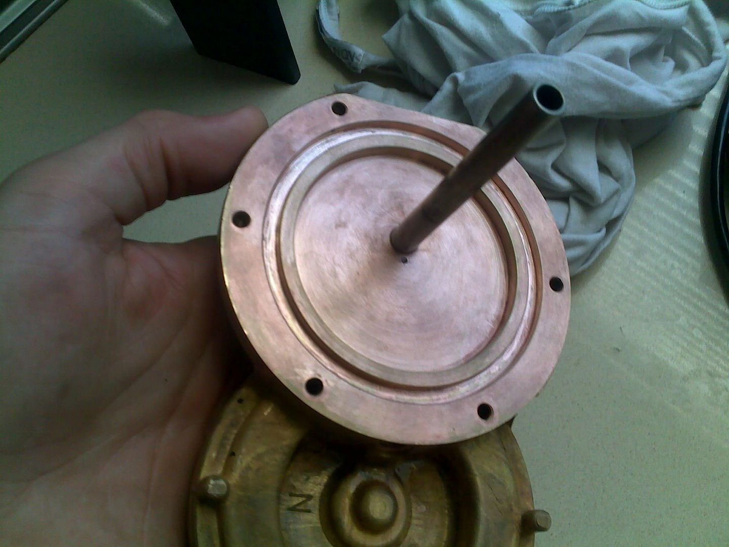

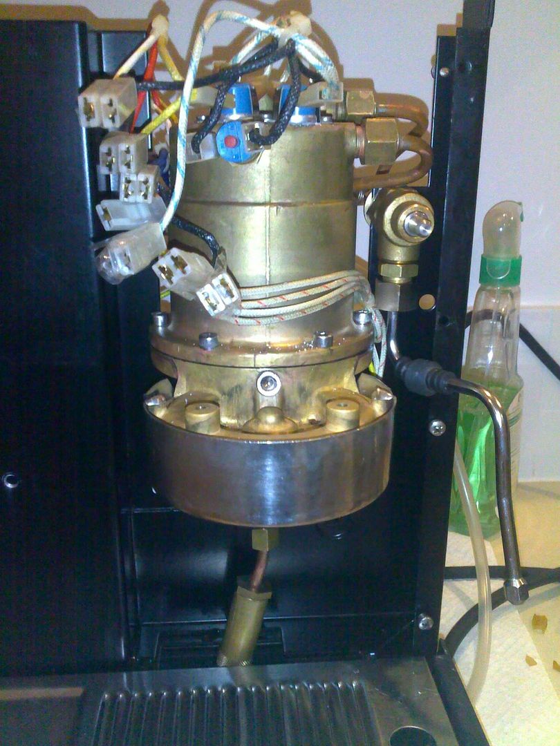

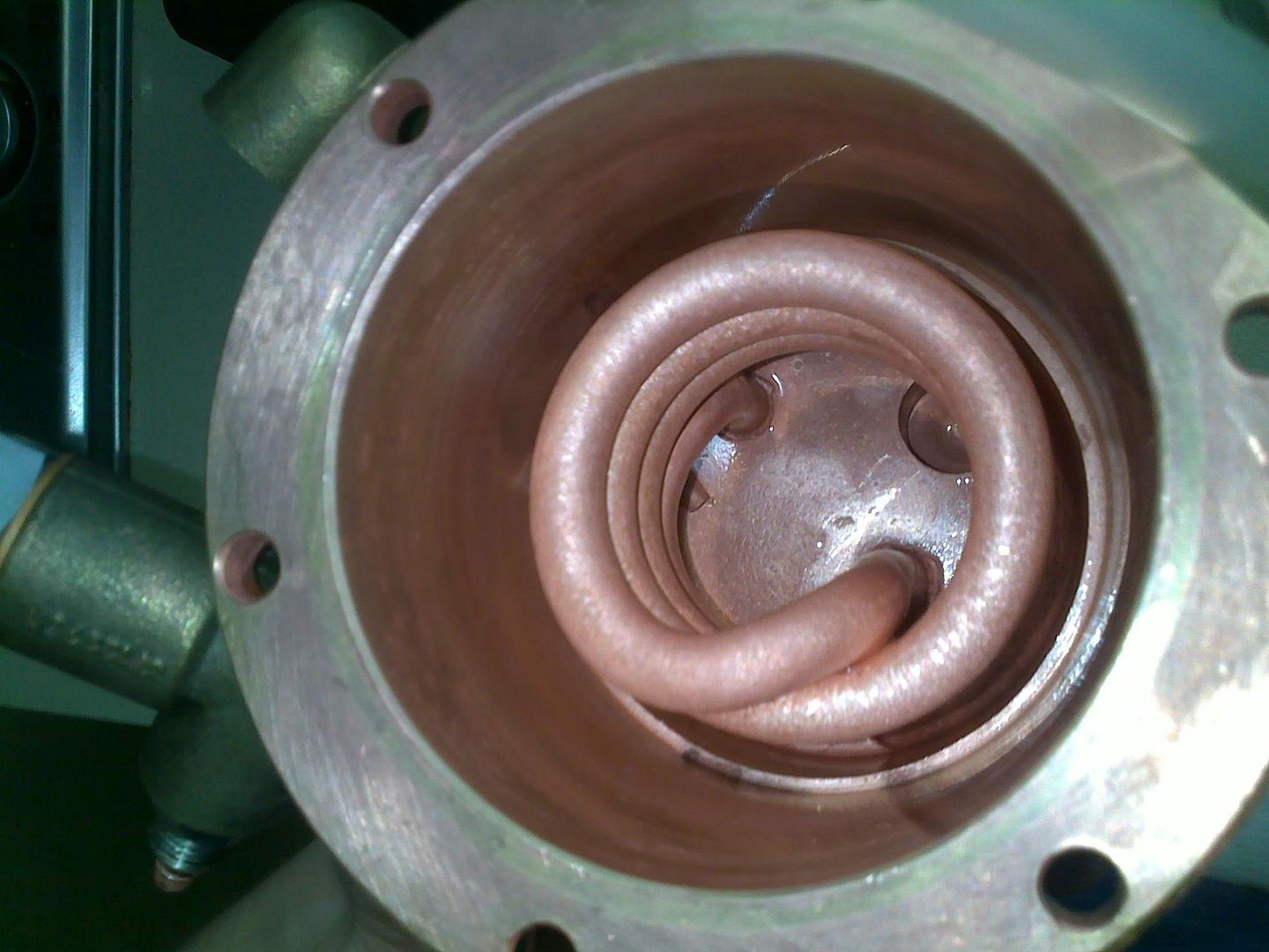

    So it was not as easy as i thought it was going to be, replacing the boiler.
    Being a Silvia boiler, and new, not 10 odd years old, its a bit different.
    Got to sort through some photos, but there was alot of pipe manipulation required.
    Im over the moon on how its turned out!
    Thanks again to Coffee Parts, next day delivery is awesome..
    Photos to come tomorrow.
    Do let me know what you think so far though people.
  • IAMLeon
    Re: My Rancilio Lucy Re-Build

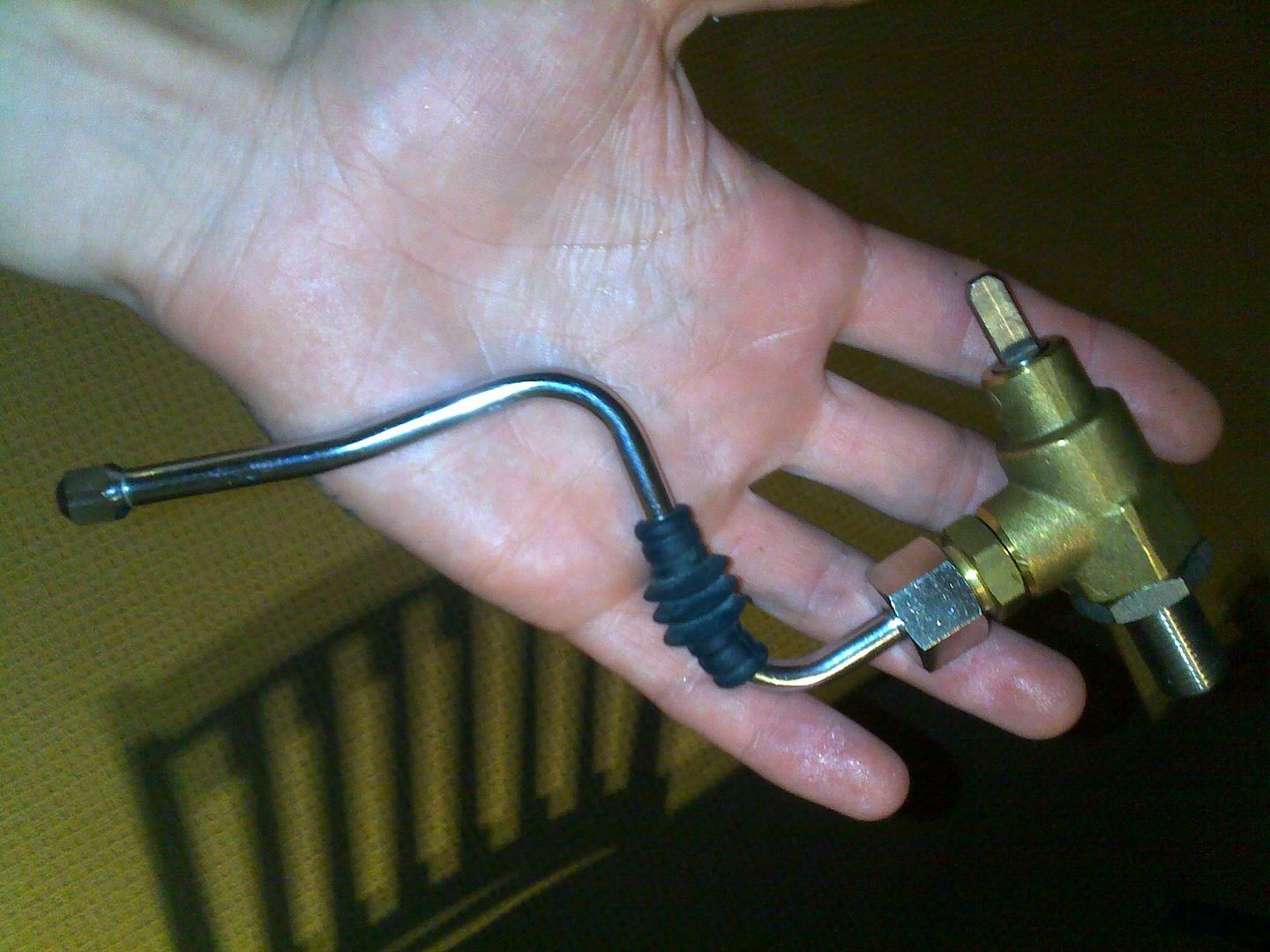

    08 Silvia steam arm, care of Hazey THANKS!

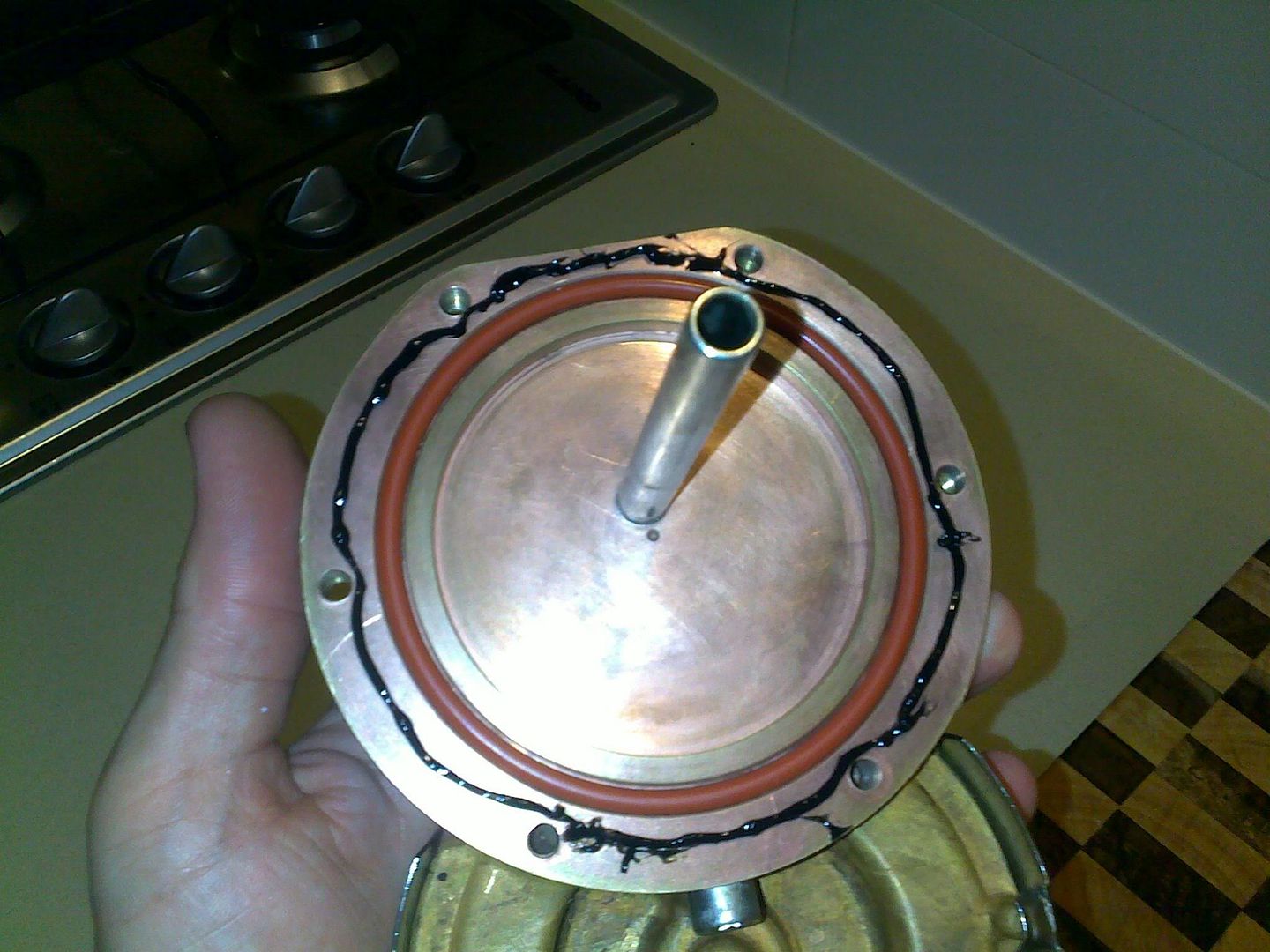

    Applied silicone sealant, not as easy as predicted, bit shaky in some spots! haha
    Mated up
    In its home

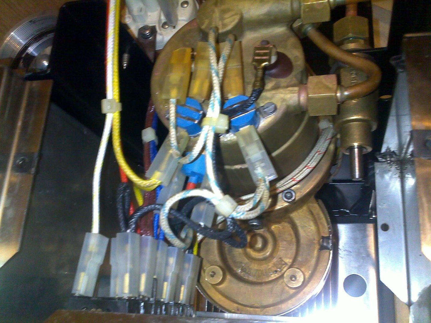

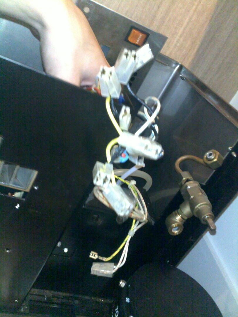

    re-wiring

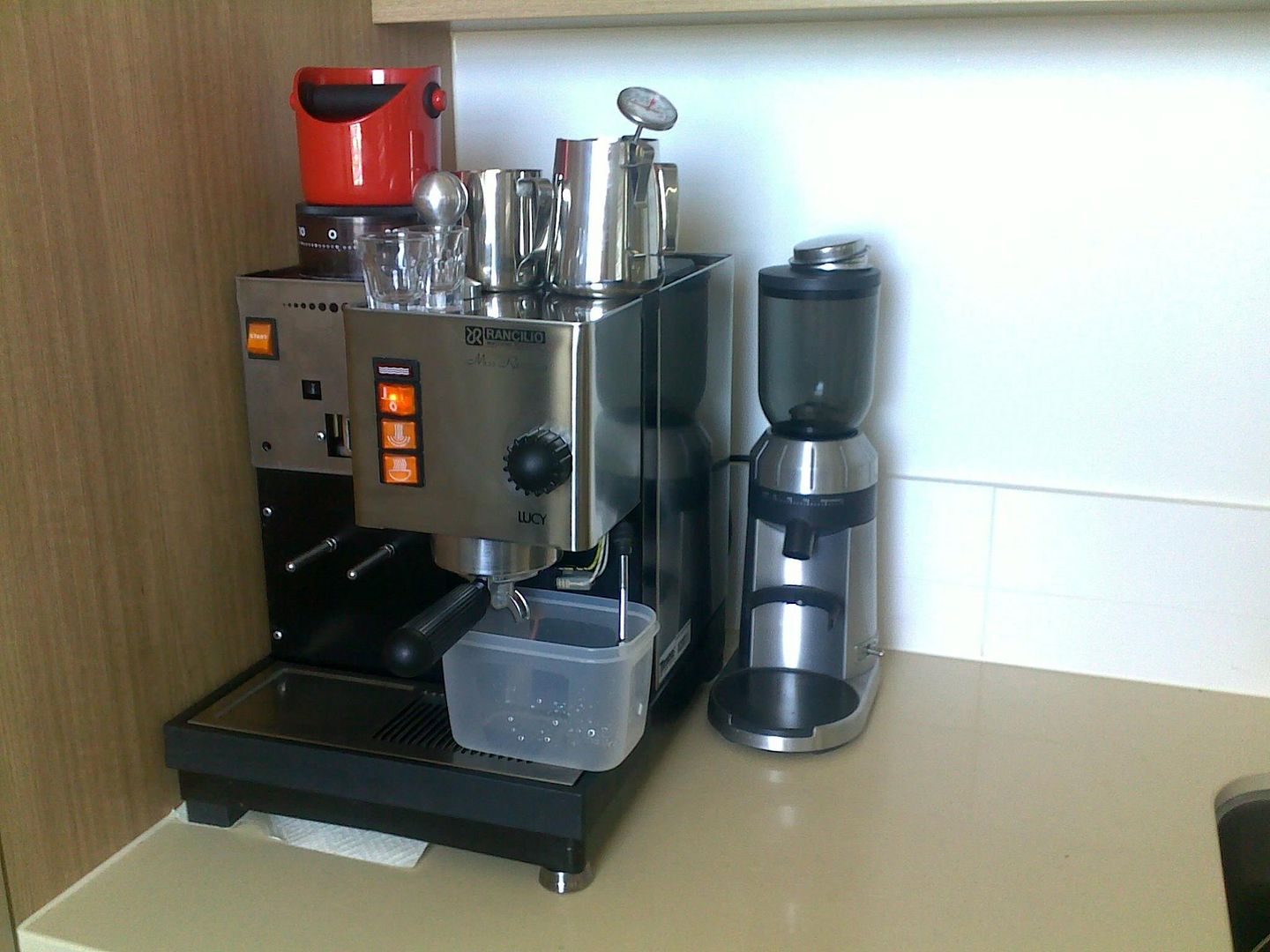

    DONE!

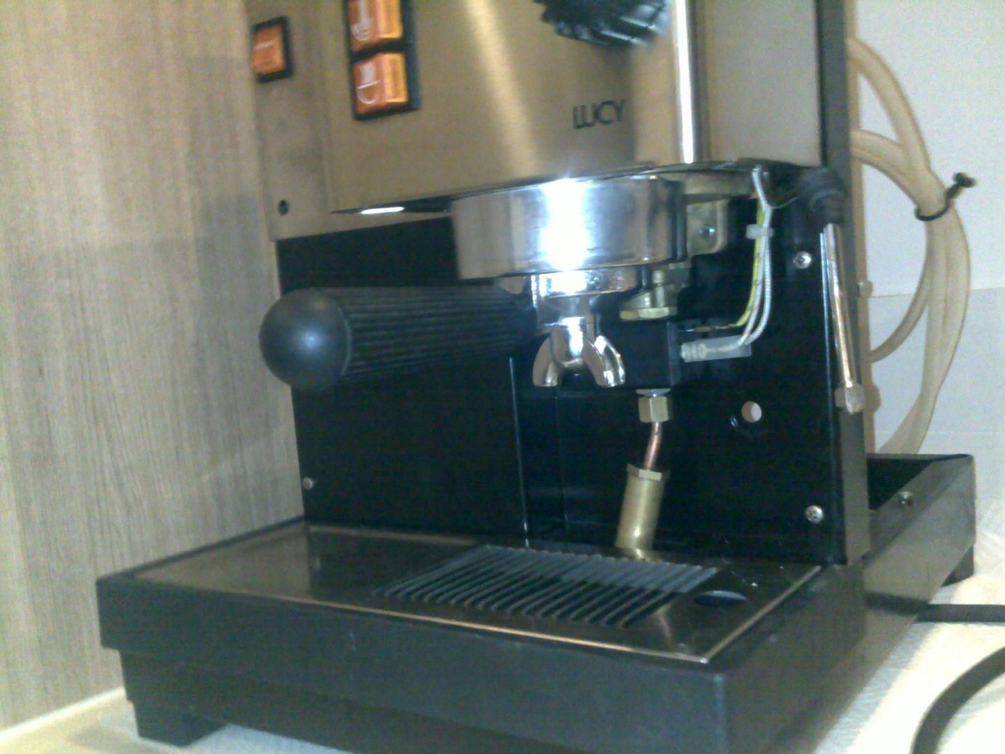

    This was on its first warm up.. well what was supposed to be a warm up, i only ever got cold water though!
    you may notice that im missing the backing plate to cover the solenoid, due to where the steam manifold mounts (further back than the silvias and newer Lucys, the plate will not mount back on.
    Also you will see i do not have the (spout?) on the grinder outlet.
    For the time being i will not be using the built in grinder.

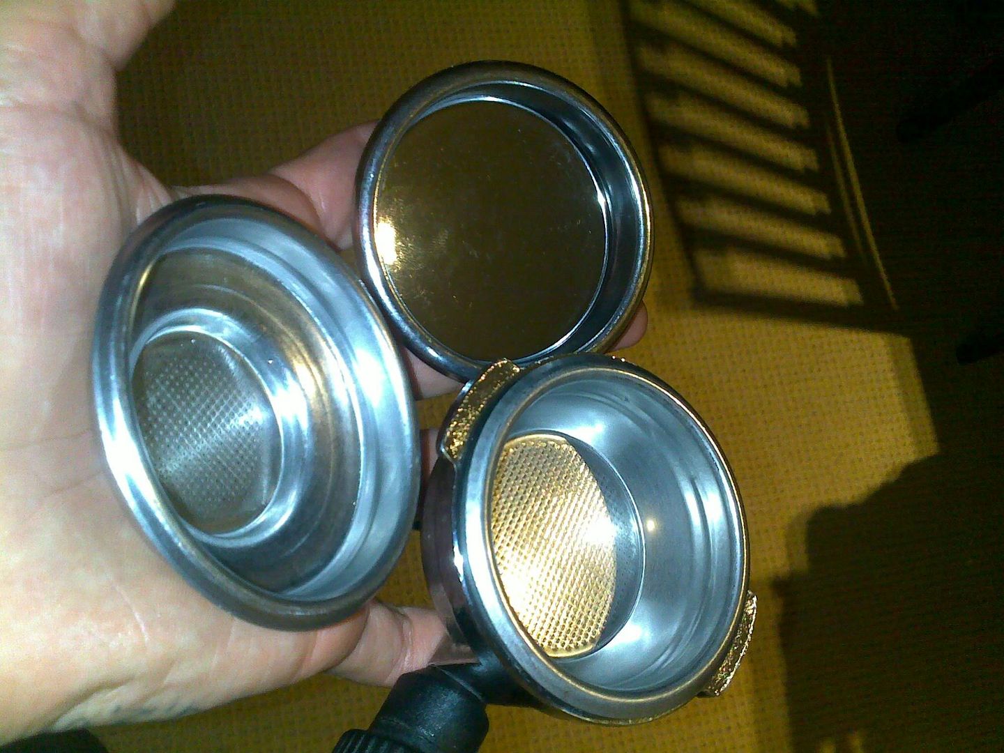

    wooo! new bits and pieces (blind basket and 14g double basket)

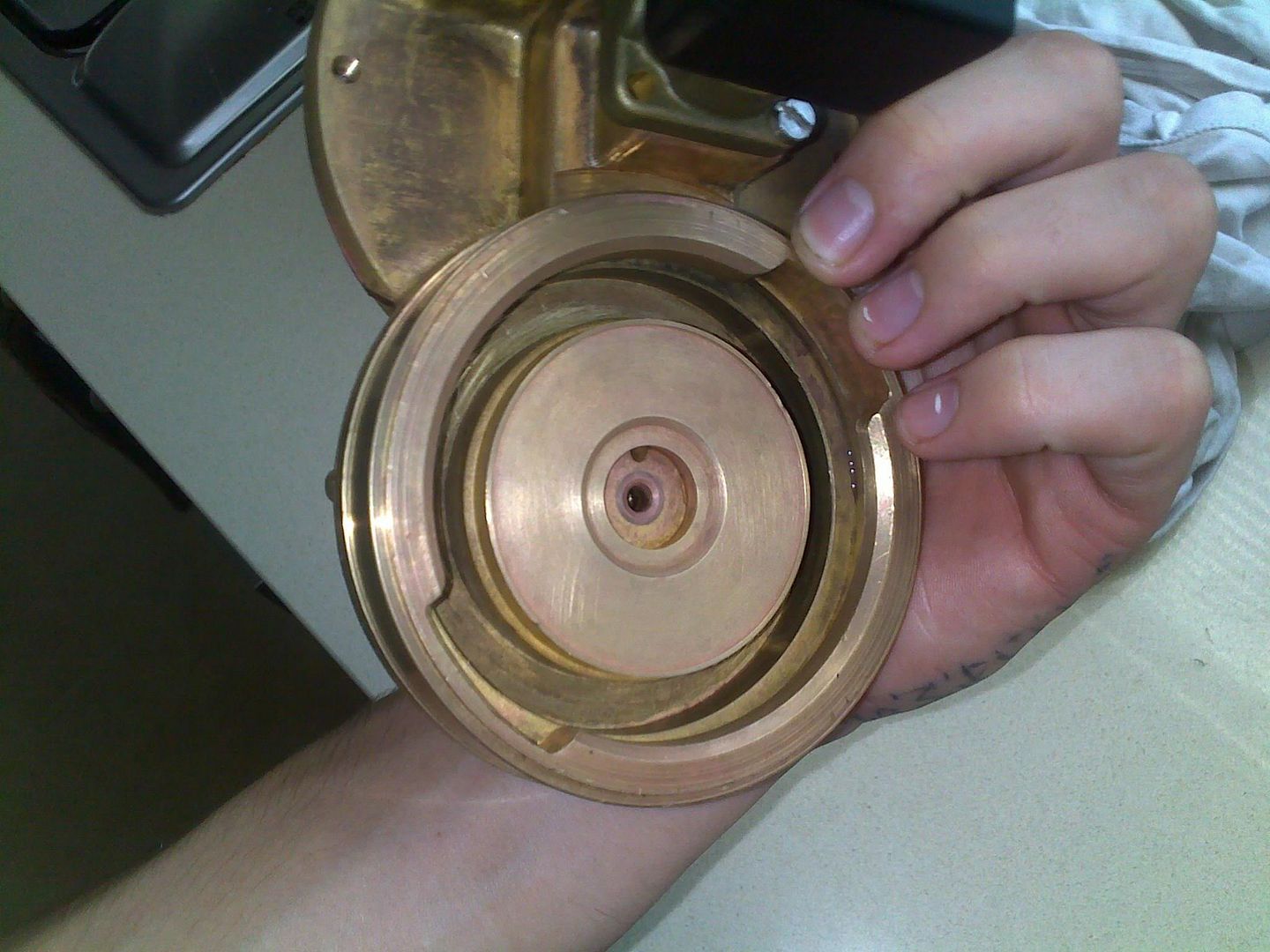

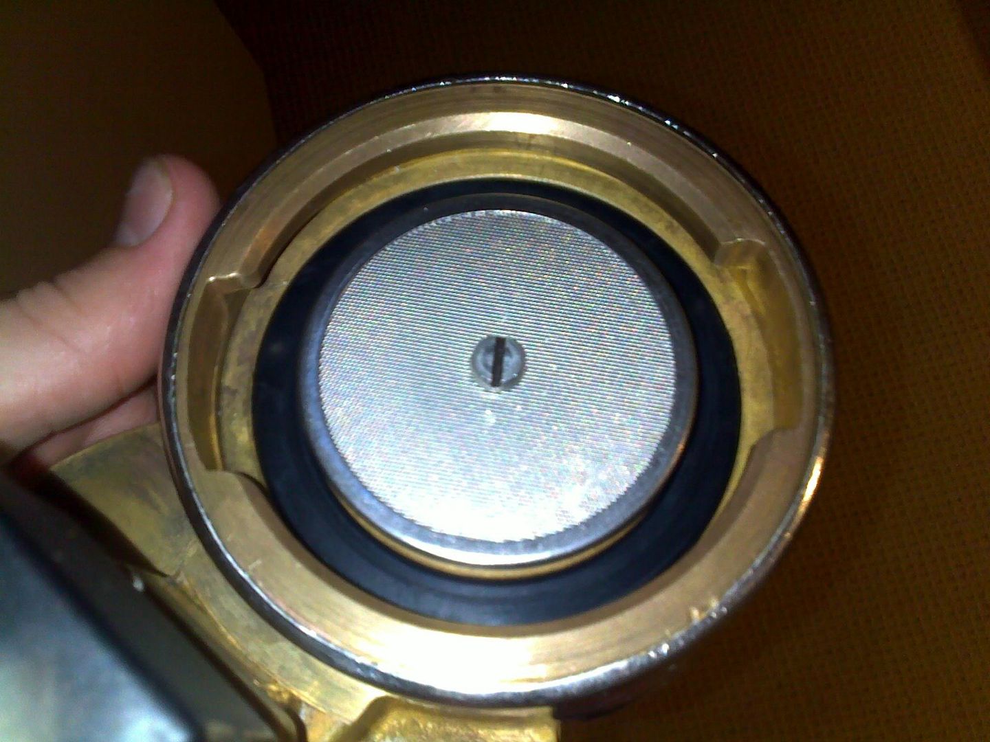

    new group seal, shower screen in place

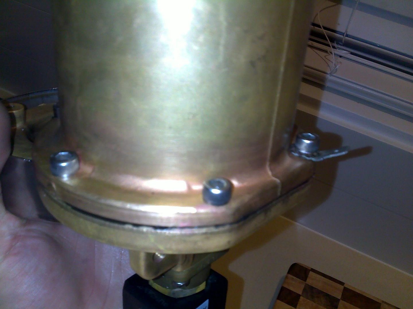

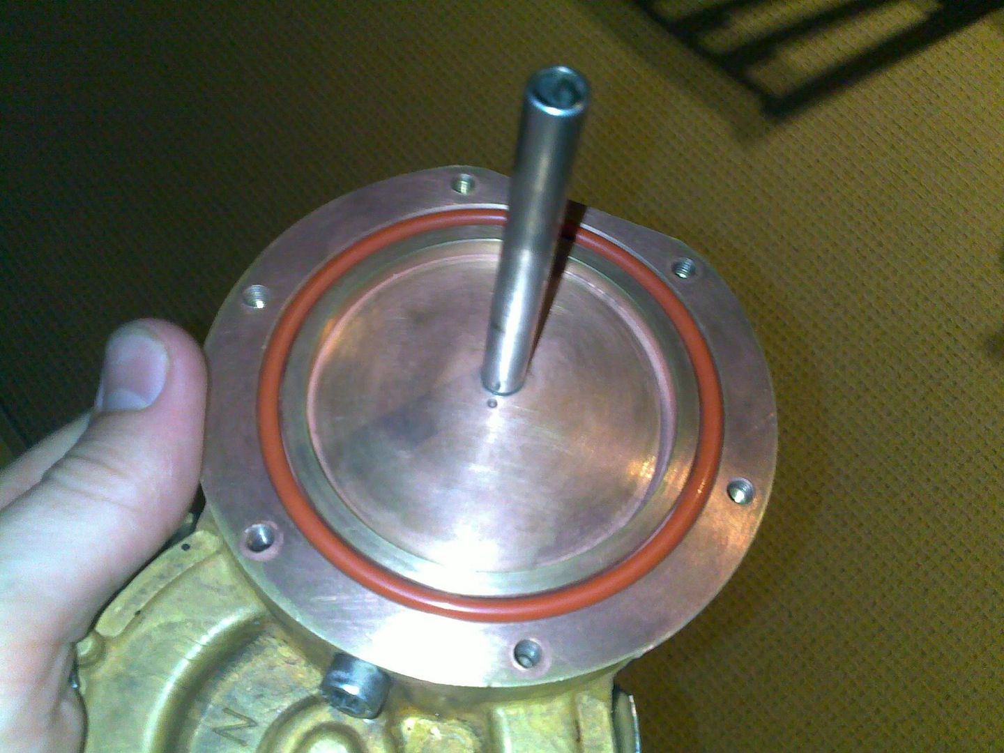

    new boiler o-ring in place

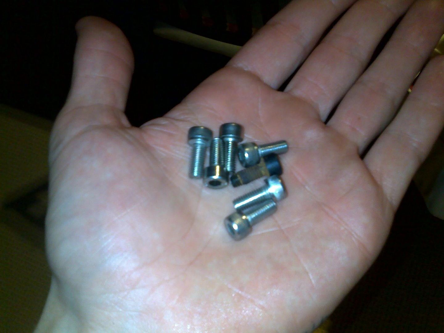

    comparison of old bolts to new SS ones these are never going to rust

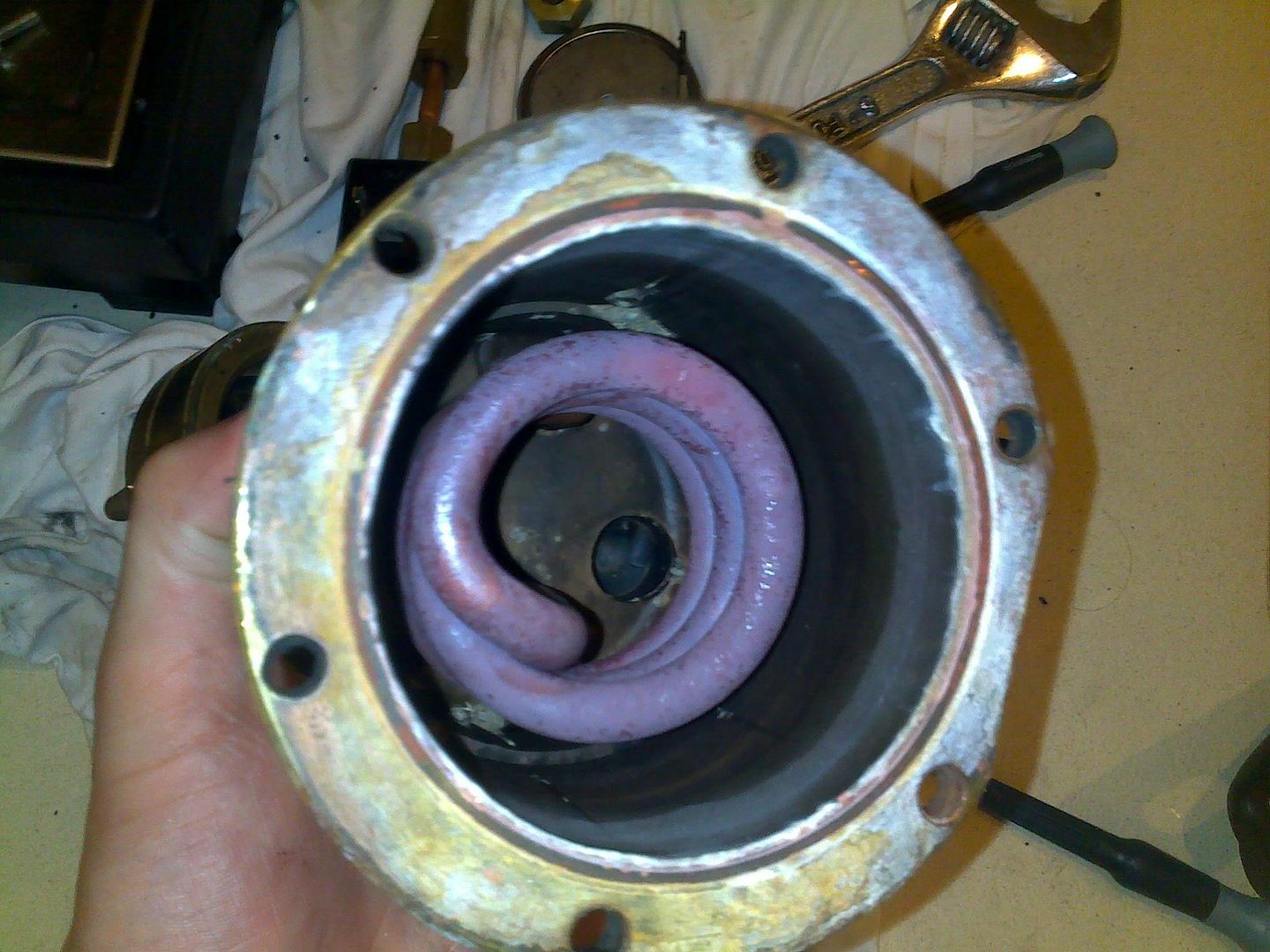

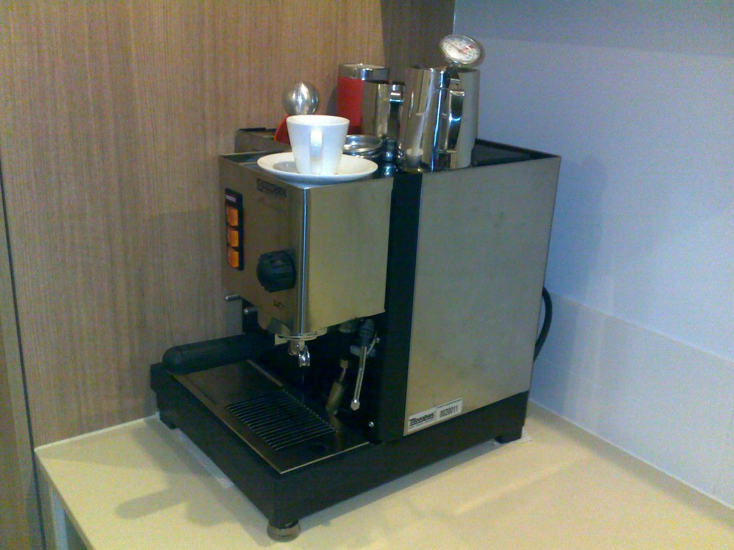

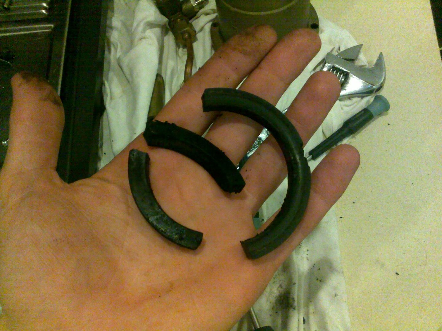

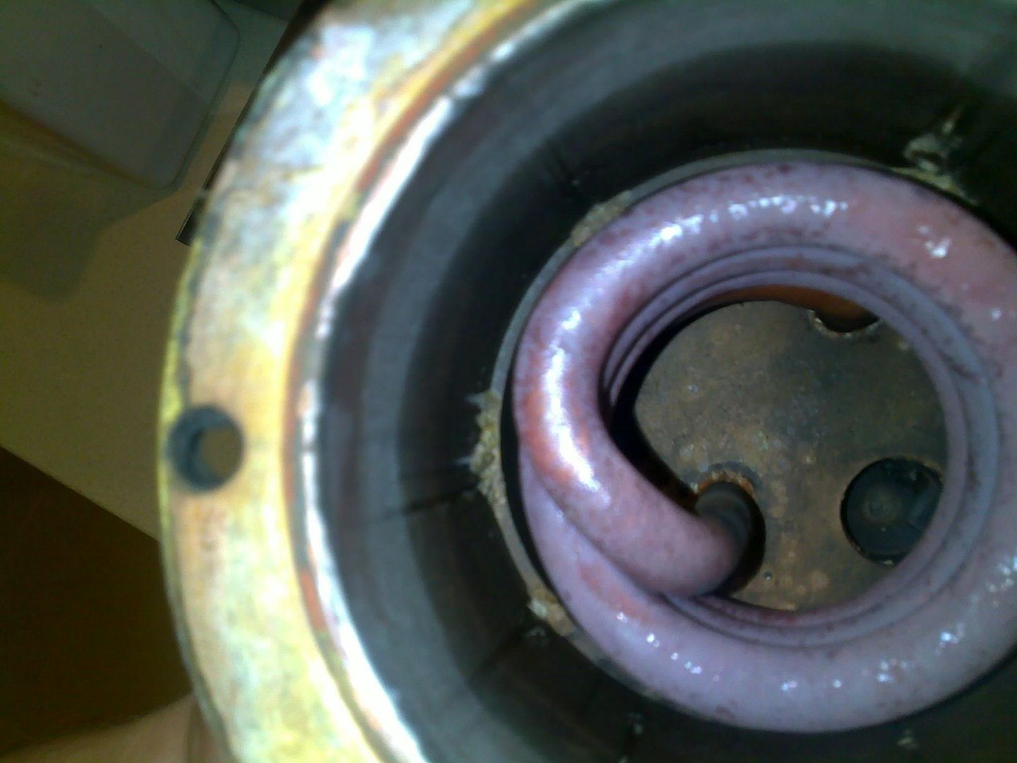

    As i stated previously, this machine i adopted from the wife to be auntie and uncle. They had apparently had the machine clean and serviced prior to them adopting something more automatic aprox 3 years ago. Lucy has been sitting tight ever since.
    As you will, i dont think this was clean or serviced, or prepped for storage either.
    This bolt (that held the group the boiler) was the best out of the lot, you will see the comparison later on.
