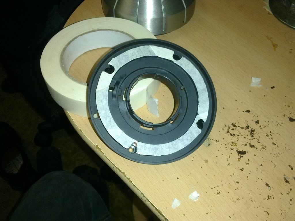

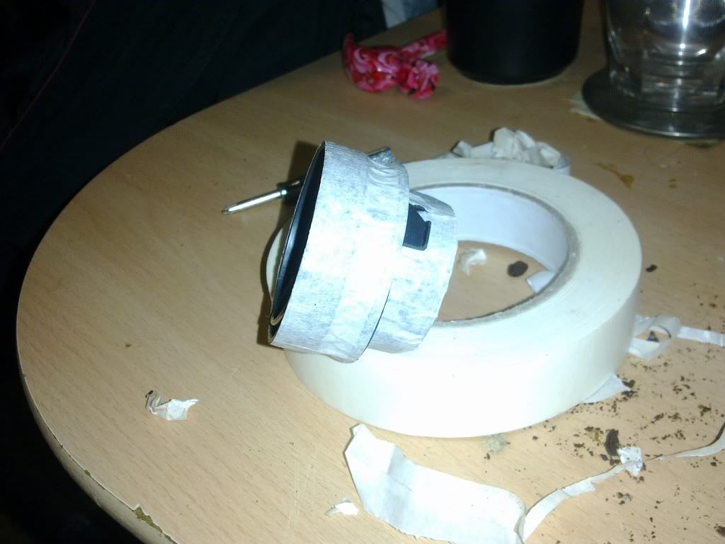

                Im also modding my EM0480 to be stepless and doing the masking tape trick, so i have my hands full for now. Will update on how the mod goes

                          In other news i just finished modding my em0480. I didnt file out the notches to make it truly stepless and as it turns out i didnt need to. After the modding i did a test shot which clogged the machine almost completely. After a little playing ive found the right setting at around 15 as opposed to 11 before the mod. fairly big difference. When adjusting as well it feels very stiff and accurate. the whole upper burr carrier used to wobble slightly before, now its nice and sturdy .

                              So after a few days ive gotten back down to the 25 second mark and roughly 60ml. Tasting very nice. The grinder hasnt noticeably improved after the mod however it does feel way more solid compared to what it was, plus stepless adjusting is great. I didnt have to file back the notches as the masking tape keeps it in place fine as it is. If i notice it slipping at all due to the notches ill go back in and file them out.
                              Heres some pictures of the mod, very easy to do!
                              Once you open it out you really get an idea of just how much grinds are retained in the chute... the whole beans probably fell in from when i took the hopper out, they wouldnt be there in normal operation (i hope :-/)
