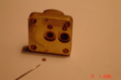

    Update.
    Whooo Hoooo! [smiley=cheesy.gif]
    I did a closer inspection of the 3 way valve,
    pushed a pin into the hole and, "voila" a hemisphere of brass, 2mm in
    diameter popped out.   It looks like that start bit, that comes from
    drilling a hole in metal, the bit that sticks to the point of the drillbit ( too many bits).   It obviously was in left in the boiler during manufacture and eventually found its way through to the 3way.  [smiley=angry.gif]  I put everything back together and am now back, in business, and the coffee tastes even better than before.   [smiley=grin.gif]  I suspect that the restriction has been floating around for a couple of weeks.   Thanks again for the suggestions and help guys.
    Bruce

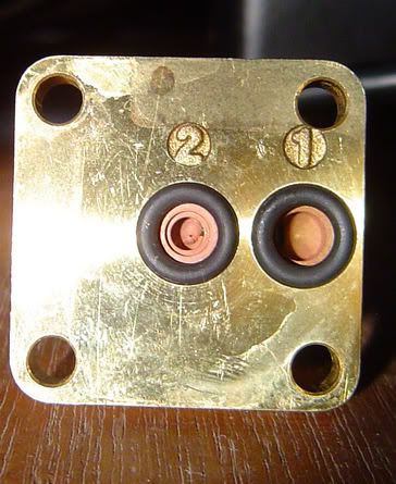

    Hi again,
    here is a pic of the 3way
    Bruce

    Update:-
    I have now cleaned EVERYTHING to within an inch of its life, even took out and cracked the boiler, everything looked in good order and I found nothing foreign that could be blocking the flow. However, on very close inspection of the 3 way valve,
    Boiler to group hole, the pin hole appears to have collapsed, but then I don’t know what its supposed to look like, can anyone help? Is it normally a clean hole? Mine looks like a torn spiral, simular to looking into a very tiny sea shell/snail shell!
    Bruce
