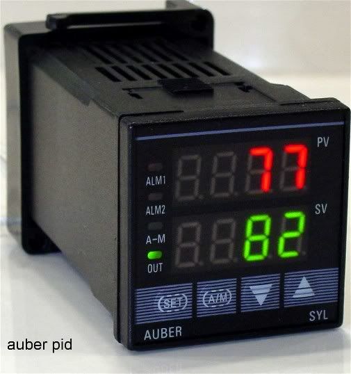

First, the obvious: choosing a PID.
I gave up on Ebay because after researching what those hitherto meaningless PID specs mean, the stuff on offer was either short on detail, unsuitable, or used ---plucked from industrial ovens. Many have electro-magnetic mechanical relays which not only go clickety-click, but are rated below the necessary current of at least 5 amps.
One, offered by ColdfusionX Universal, the TET 7100, looked promising. But a Google search showed it got poor reviews and has a one-line display anyway.
Last year I spoke to Ron Fowler, at OneTemp, but the quote was too high at around $200. This time I spoke to their Melbourne office and was quoted $294 for their supposedly “cheapest” controller, a Shimaden. SR91. And $34.20 for a 40-amp relay. Plus GST.
Add a few more dollars for a box, wiring, bracket and terminals and it’s all looking like a ridiculous add-on for a $700 machine.
I was resigned to give up on the whole project when, back at Ebay I came across a very modestly-priced model which had all the features I sought.
To be continued.
