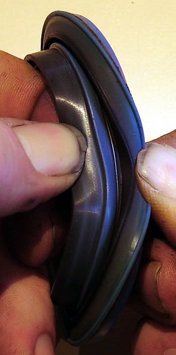

                  If you have never replaced your seal...  It will be dead...  Even at 6 months I have not seen one that is not well on the way out...  With teh seal out flex it and look at the groves...  They are just shallow groves... If they are deep etc then teh seal is stuffed...  Will send a pic once I get home...  At the Vs at present haveing a coffee :-)  Cupping about to start.
                  Your could have also had the collar come away from teh head...  Check teh head screws... Note you will need teh top off to do this...
                  Here is a pic of a NEW one and one I pulled from another machine... My grubby finger is attempting to point / demonstrate the deep cut into the seal, while the new one is in the background.
                  NOTE: Some one tried to use a sealant on the old one, but they did not understand the physics and teh way the shower head and screen fit into the seal....
                  Trust this helps.
                  • #24
                    Re: EM6910 pressure gauge stopped working...bitter coffee!
                    Originally posted by 527D7476615E727D7274767E767D67130 link=1249003655/22#22 date=1249087775
                    If you have never replaced your seal...It will be dead...Even at 6 months I have not seen one that is not well on the way out...With teh seal out flex it and look at the groves...They are just shallow groves... If they are deep etc then teh seal is stuffed...Will send a pic once I get home...At the Vs at present haveing a coffee SmileyCupping about to start.
                    Your could have also had the collar come away from teh head...Check teh head screws... Note you will need teh top off to do this...
                    Trust this helps.

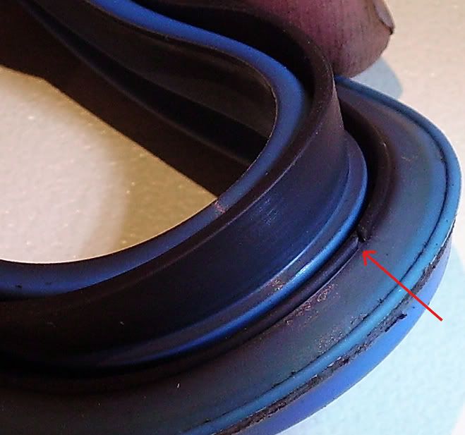

                      The nick is interesting, but the depth of the main grove is significant...  Much deeper than teh new one I have on my desk.

                          My two month old seal had a nick just like the one in this photo. I rang SB and they asked for a copy of my receipt and sent me a new seal
                          I noticed the nick during a cleaning session end decided to have it replaced even though it hadnt yet caused any problems.
