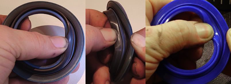

    Hi, I located this blog after googling for a lack of pressure when making a coffee, and back flushing on my EM6910.  Ive already swapped the old cracked blue silicon seal (which didnt fix my problem), so the next step is for me to replace the collar, I think.  Anyway I know have a new collar, and not much of a clue on how to disassemble the machine....If anyone has these instructions I would be very keen to get a hold of them..thanks in advance...

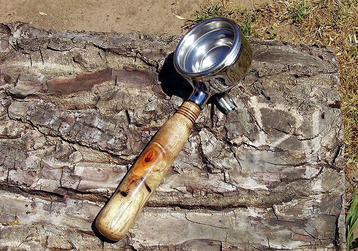

    Group handle done, and made from drift wood...
    and here tis. Im pretty sure its a piece of Camphor Laurel by the smell when I sanded it.
    Filled the grub holes with a black-tinted 2pac filler and gave it some spit shine. I had to clean up the threads a little so it would screw into the group handle. :-[ Whats holding the threaded rod in AM?
    I am sure it is Camphor Laurel as well but was deep in a sand dune a bit back from the beach on Morton Island - Surf side.
    I use two types of thread in general - Metric and Withworth seem to be the most common...
    Some of these come as furniture studs the rest as threaded bar, which I then grind and machine to allow a solid fit.
    If I remember correctly I did get caught with an EM a little while ago... And I could have with you as well... I think it is an issue with 3/8 Vs 8mm but can not be sure as I no longer have a EM6910 group at home... Thus MY mistake... Sorry about that.... :-[
    It looks great...
    I just need to get out and collect some more bush timber... Make a few more and then do the thread to suit as a job by job basis. I drill to suit the thread so that it cuts into the wood a little and then remove the thread add some pva glue and then screw the thread back in.

    Group handle done, and made from drift wood...Left a few little grub holes in just to add some reminders of what crap can do..Grin
    Really? bloody legend, I didnt know you could even do that. Does the black plastic handle just screw off? I should make you one, I have some pretty awesome desert timbers. 8-)

    Glad I changed over the collar while I was at it, probably couldve got away with it as it was, but its sooo much better now. I think my old seal was still usable, but changed it anyway. It feels like the machine works better than it ever has. Im refining my technique until Im happy, then I will do a little vid.

    I might have to do up a wooden group handle for him..  Then he can carve in the date as a reminder
    Hmmm, extreme way of getting a wooden group handle I reckon  ;D
    Group handle done, and made from drift wood... Left a few little grub holes in just to add some reminders of what crap can do.. ;D
