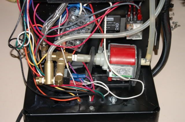

UNDER THE BONNET
Lots of extra bits shoe horned into here. A three way fitting is attached to the pump on the end is the original right angle fitting which the original braided hose attaches to, on  the side of the 3 way fitting is the 2 way solenoid then a right angle fitting to the isomac OPV which has the other outlet plugged OPV water line goes back to the tank. On the back wall is the solid state relay for the shot timer and on the right hand side is a small relay to cut power to the element during the shot, more about that later.
The OPV spring had to be cut down to get the pressure down to PI range I couldnt source a softer spring but a local spring works had a identical stainless steel spring to the original so I just kept cutting loops off that till I got down to 2 to 3 bar, the original is still untouched.
