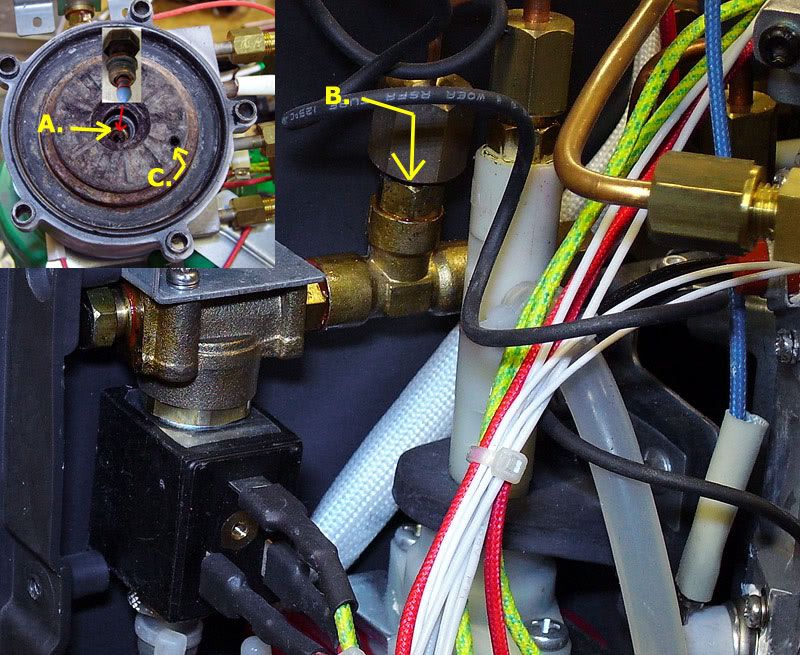

    I dont think thats normal, mines never done that. See if any of these pics help?
    Awesome, these helped a treat.
    Red blue white brown black.
    I put it all back together and it WORKS :-)
    Reading some of the other threads RE water leaks. I may have dripped water on the board and which might have dried out in the two days since I pulled it apart.
    Thanks Matrix for the pics!

    Re: EM6910 - Replaced group head lock, now machine pumps water when AC is switched on
    It looks to me like martrixs pictures should sort out your wiring.
    Id guess its priming.
    Dont you remember it doing that when it was first turned on when new?
    Im guessing you lost some water when removing the thermoblock therefore it was basically empty (like when new).
  • martrix
