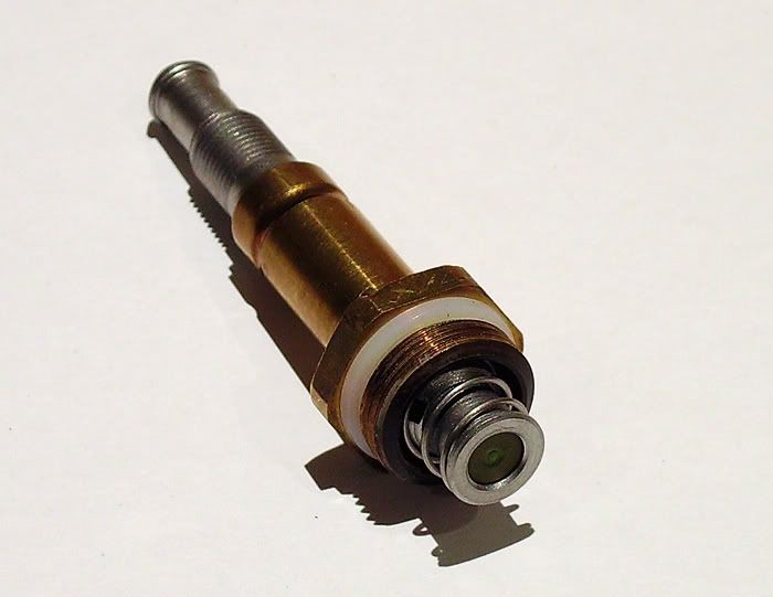

    There is a blockage in the head in the line b/w C on the diagram above and the rear of the head. I disconected and cleaned all the copper lines b/w rear of the head and the 3-way. I can blow air through them but not from rear of head through to C.
    Two symptoms: no reading on pressure guage & pressure not released after in head after brew is stopped.
    I cant blow air from B through to C
    Pic again to make it easier
    ps you cant see it from this pic but copper line runs left-to-right out from the 3-way/soleniod straight to the back of the head.
    I am correct in thinking that when the brew cycle is stopped that the solenoid should open allowing the pressurised liquid in the head to run out through C, past B, through solenoid valve then into the drip tray?

    Bman, I would suggest first you disconnect you pressure gauge line (at B in pic above) and then blow compressed air through it to see if anything registers on the gauge.
    Be super gentle with this copper line as it is hollow and will only take a few bending sessions before it will develop a crack.
    If that checks out with no major leaks then I would be removing the solenoid valve and clean it as per my post. Make sure all the little rubber items are moving correctly, study the little bugger and soak, clean, soak clean in Cafetto.

    Ok sidecover off and fitting nipped up (it wa sthe one at the bottom od the copper tube that feeds the steam thermoblock) Thanks agian AM. Martrix will be served one of my best beers when we meet ;D
    The story now continues -
    I went to Jetblack for one of their home barista courses last week (excellent course from Deb and Charlie who know all the ins and outs of the various domestic machines. I can highly recommend it)
    Charlie noticed that the pressure guage wasnt working. It stopped in the first week we owned the machine and I figured that the pain of losing the machine for 1-2weeks while it was repaired was more than the pain of living without a guage. Once we started pulling shots Charlie observed that the three way valve was not working. Im now convinced that the two are related. The first option was to leave the blind filter under pressure overnight with the machine in standby mode in the hope that the cafetto and pressure would release the blockage. All this achieved was to deform the blind filter
    While the cover was off I used the link above to check a few things. I removed and dissaembled the 3-way valve which was in surprisingly clean condition. I clreaned it anyway
    I then back-tracked using Martrix air trick and located a blockage in the group head bw C and the swage fitting at the rear of the head. Ill pinch his diagram to explain
    When I blow through B. Air it doesnt come out C. I had the 3-way valve disconnected but Im fairly confident its not the culprit as I can hear the solenoid clicking when I hit the brew button and Ive just cleaned it internally.
    Im right in thinking that air should come out C. yes?
    I spent all afternoon squirting cafetto down into the orifice (from both ends) with a syringe and poking with s/s wire. Left it o/night with cafetto soaking but still no air would travel though. I reassembled this morning because I wanted a coffee and I was hoping in my heart that a backflush would blow out the blockage after the attention of yesterday. But Im still in the same situation.
    Im hoping to draw on CSs collective brainstrust to offer me a better way to unblock it or am I just gonna have to bite the bullet and buy a new group head?
    The machine is two years old so its well out of waranty and Im not prepared to put up the fight with SB that its a waranty job because it occurred during the warantee period - two chances Id get a good result from that one I reckon :-[
