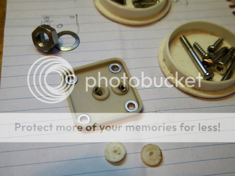

                            • My BES900 is 4 years old. At 2 years old it was serviced due to falling pressures. Similar thing happened again. Instead of 9 on the gauge I get 5 with a blind filter and about 3 when pulling a shot. I dismantled solenoid gasket area and replaced button gaskets with newer kit gasket and used the washers shown which prevent excessive crushing of gasket and fluted liners which are presumably to stop gasket spreading too much and blocking holes. However, it hasn't changed pressures. Any suggestions what else may be the problem?
                              http://i427.photobucket.com/albums/p...0/IMGP0704.jpg
                              • The square gasket was a temporary solution for affected machines, the round teflon washers are the upgrade from that. There won't be an issue with running the square gasket, it's just not the repair that's carried out anymore.
                                Chances are your over pressure valve is leaking causing low extraction pressures. The pump can also be an issue in the older machines.
                                Does the pump sound very quiet or not operate at all during pre-infusion? Does the pump pulse or change in sound whilst pulling the shot? If yes to either or both of these, your pump should be replaced as well.
