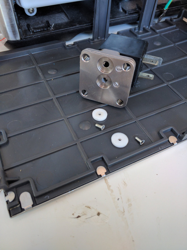

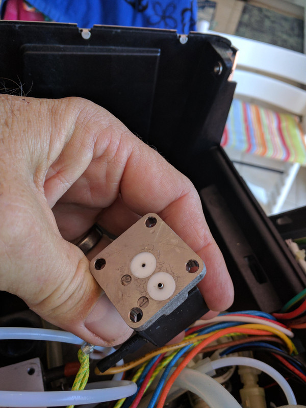

        I can confirm this. ^^^ I got a new solenoid in 2015 that had the teflon discs AND the metal reinforcement ferrules. The metal reinforcement is a sensible thing, as PTFE is known to cold-flow.
        Here is a picture of mine after about three years of service on this particular solenoid, right after I removed it. There is a little bit of clear residue. That was a little dab of silicone grease I put in place when I installed it, to keep the silicone discs from falling out when I was lowering it into position:
        Here is a more detailed view of the discs and the metal tubes that support the holes, cleaned up a little before re-assembly:
        At the time the picture was taken, my pump would make full brew pressure, but would not pre infuse. Changing to a new pump did not fix the lack of pre infusion.
        -Peter

          The silicone seals don't fail in the same way that the teflon discs do. I've never had any problems with them.
          It's possible there's a blockage somewhere else in the brew path or that the new pump is faulty. I personally have always had success with installing new pumps to fix preinfusion problems and am yet to see a faulty circuit board be the cause. I'm sure it's possible for the board to be at fault but from my experience, it would seem very unlikely.
