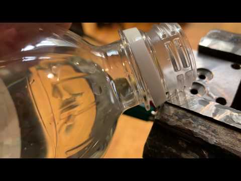

    I am back, baby! I disassembled the machine and removed the solenoid valve again. It looked clean but what about inside. So I popped it in my workshop vise with the flange facing up, then took 3 test leads and connected to the solenoid (it is a 120v AC unit) to wires I probed into a nearby electrical outlet (please don't try this at home unless you know what you are doing). I was then able to cycle the solenoid valve at will by working one of the hot wires. Then I poured some vinegar on the flange and cycled the solenoid. The vinegar ran through it to get to the insides and out the outlet tube. Then I blew it out with compressed air. Reinstalled the solenoid and voila, major flow... 8 ounces of water in 40 seconds with no coffee... it had been only 2 ounces in 60 seconds before. I had to totally revamp my grind, dosing and tamping to accommodate the flow. getting perfect shots again.

      • Maybe I'll try that next time, but the vinegar treatment was very easy and worked great. It's like a whole new machine. Here is a brief video, please excuse the slightly jerky result as I was filming with one hand and working the wire to cycle the solenoid in the other. This from a second pour of vinegar. Got some mucky stuff out the first one.
