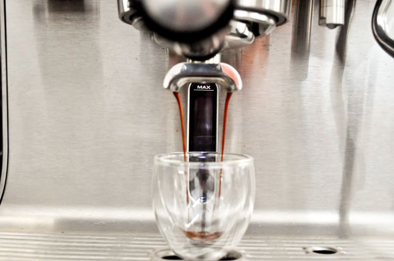

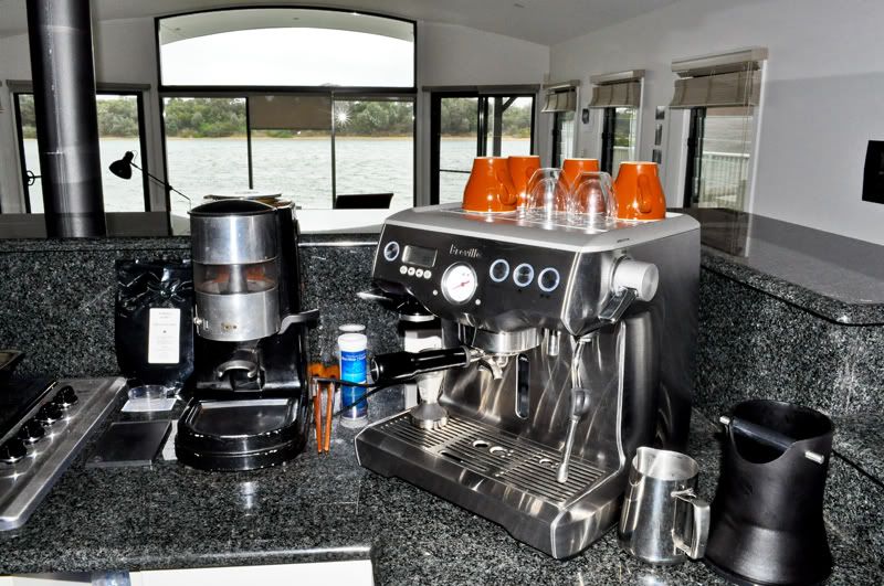

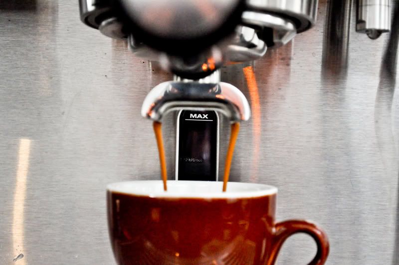

                              Okay, so a week into using my BES900 and I’m ready to put in a review.
                              Firstly, I have to commend Dennis at Cuppacoffee for terrific communication and service throughout the buying process.
                              Now the machine was well packaged and easy to open. Very quick and easy to get onto the bench and up and running. Placing the filters and other paraphernalia in the water reservoir ensures the user realises to install a filter before filling the reservoir.
                              The machine appears very well built from the outside. It is very neat and seems sturdy enough. All the buttons, dials and the guage seem well fitted and operate smoothly. The paddle on the steam wand would feel a whole lot better if it was metal though. The portafilter is nice and heavy and seems well made and fits into the machine in a reassuringly sturdy manner. It all feels quality above what you would ever expect from an “appliance” company. But this is what I expected of this purchase too, given the price and the reviews that had come before it.
                              The machine has a great large sized reservoir and very convenient section at the top front of the machine to fill the reservoir without having to remove it. Visibility of water level is also superb from the window at the front and the LED that creates a shimmer on the water surface.
                              The machine was very fast to reach temperature, however I am finding it is still best to let it warm up for at least 30 mins for optimal results. I leave the portafilter in as loosely as possible so it heats up as well and don’t have to run the hot water tap as much to warm up everything. I still use the hot water tap to warm my cup as the cup warmer only takes the chill off the cups rather than making them hot, at least on these winter mornings anyway.
                              A lot of the little ‘added extras’ that don’t add to the result in the cup, certainly add to the pleasure of using the machine. The built in clock and auto turn on feature so I can have the machine turn on 30 mins before I wake up. The built in shot timer. The retractable wheels to move the machine around the benchtop for cleaning etc. and yet sits firmly in place with the wheels retracted. The easy to fill reservoir as mentioned. The large drip tray with very easy to empty ‘spout’ section and the tray that hides behind it that holds all your tools and spare baskets. It really is a well thought out machine that is a pleasure to use.
                              Before getting onto what’s in the cup I’ll give some background first as requested by Chris. My coffee history starts with supermarket coffee in a plunger, followed by stovetop moka pot. Then onto a low range Sunbeam espresso appliance and discovering fresh beans but having them ground in 200g lots as I had no grinder. Upgraded to a 2nd hand Imat Junior (a previous incarnation of the present day Lelit/Mokita etc.) and then paired that with the EMO480 grinder when it was released. I then went onto my Pavoni europiccola and a Fiorenzato Doge grinder and, of course, home roasting.
                              Now the BES900 certainly has it when it comes to what’s in the cup. I have been producing amazing espresso, very rich and even creamy espresso with a very broad flavour profile. It really allows for a lot of the beans nuances to shine through. The best shots I have managed to pull on this machine rival anything I have had anywhere. I’m still practising on being able to pull those sort of shots more often though. That being said, I am consistently getting very good shots already. It is an easy machine to get good coffee from.
                              I should mention I’ve been using an espresso blend from Cuppacoffee that came complimentary with the machine which is a Ugandan Bugisu and PNG Kimel Grade A blend, and some of my home roasted Yemen Mocha Ismail. And grinding with my Fiorenzato Doge. I’m using a VST 18g basket with fitted Pullman Barista tamper. A plug for Pullman tampers here too – great to do business with and an amazing quality product.
                              The temperature stability of the machine seems flawless. I have only been using the preset 93 degrees so far whilst I learn the machine but it seems flawless to me, producing incredible results in the cup. I am excited about learning to play with different temps with different beans in the future. And this sort of temperature stability is a godsend coming from the Pavoni where everything revolves around and hangs upon pulling the shot at exactly the right time to get the right temp for extraction, and after two shots there’s no more unless you like burned espresso.
                              The BES900 is an amazing luxury for me in that I can walk up to the machine at any time and pull an espresso at perfect temp, and can pull as many shots in a row as I am likely to ever need whilst steaming milk simultaneously. I still love my Pavoni, but I must say the BES900 has taken over in a big way. It produces a far richer and bolder espresso than the Pavoni and the Imat previously, which also allows for more flavours to shine through on the pallete.
                              Now the steam was disappointing in power for me. Having used some E-61 type machines in the past I was expecting steam to be similar if not even more powerful. This is not the case. However, that being said, it seems I cannot help but get really good microfoam from this machine. I think I would have to try very hard to get bad microfoam. It is really easy to use and produces great results, and since it’s a home machine with no need to keep up to a line of customer’s demands, a lack of power really is a small complaint.
                              Overall, I love this machine. I am producing consistently great espresso with the occasional shot that rivals anything I have ever had. I know this machine can put the goods in the cup. It is also an absolute pleasure to use with all the added extras. It is only one week in, but I have had absolutely no problems with the machine’s operation. It appears well built from the outside, I am willing to take the word of others on this forum who have seen the insides that it is also well built on the inside. The machine is simply great value for money. In my mind the kind of machine to better  the BES900 would be something like the Alex Duetto which costs a whole lot more, and even still would probably be a very similar quality result in the cup. I can’t help but recommend this machine to people who are thinking about it as their next machine.
                              Below is some shots of my setup along with a glimpse of my view whilst I prepare my coffee (and that is on a dark rainy day!), and some pour shots. I found the pour shots a bit difficult, as I attempted to start the (coffee) shot and then quickly setup the (camera) shot, so the focus ended up more on the backplate than the espresso pour.
