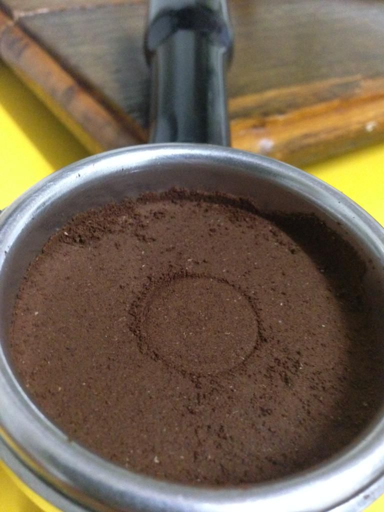

          Dose: I'm using a 15g VST basket and weigh out just under 16g. Here is what it looks like after tamped and after the 5c test. (Btw please let me know if these photos don't show, it's my first try)
          Maybe a little bit high?

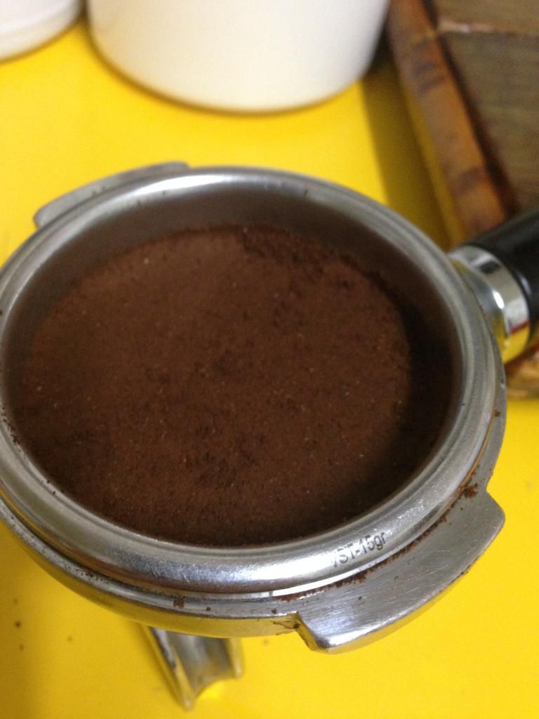

                      Did you do that? and adjust back to coarser grind to get 60ml in 25-30s? from your 2nd picture I doubt it's little coarse. anyway waiting for your video
