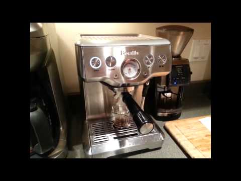

    The pulsing on my machine is a little different from the video... It's down to how hard I tamp (which I haven't measured but suspect is more than recommended), so if I back off on the tamp the gauge gets to 1 o'clock and stays there... So I've concluded it's an operator controlled factor, not a problem with the machine.

    I don't really use the temp function as I can't really tell if there's any improvement to the shot. What makes the biggest difference is the grind, dosage and tamp. My machine hasn't pulsed like that either so I can't say what may or may not have gone wrong. And stay away from the dual wall filter!

    When I first poured a shot using bought ground coffee and the dual wall filter, I tamped way too tight after overloading the basket. The gauge maxed out on the scale and the coffee only came out in drips but there was no pulsing.
    Spare parts diag. for 860 and others show a "safety valve" - can't find a schematic for the 840.
    I've been experimenting with a lighter tamp after watching a video and reading some stuff which suggested you can basically tamp with very little / no pressure. With a lighter tamp I'm getting the needle on the gauge sitting in the 1 o'clock position without the pulsing / surging, so my conclusion is that it must be an over pressure / safety valve thing.

    I'm wondering if these machines have an over pressure valve... It only seems to do it when I make coffee, not when my g/f does, and I tamp with a bit more weight...

    Originally posted by lappa View Post
    My 870 does not pulse like that. Small pressure for pre infusion then up to 12 o'clock and rock steady for the rest of the infusion.
  • lappa

    Does anyone else find the pressure sort of "surges" or "pulses" when doing an extraction?? As in once it's done pre-infusion and goes full pressure, the gauge hits the top end of optimum zone / start of over extracted, then drops off back to the middle / lower end of optimum, back to the top etc etc until the extraction is done, and of course you can hear the pump or something going up and down with it.....
    I noticed my BES820 also did the same thing while extracting... The 2 x BES800 / 800 Series I've used have not done this surging / pulsing thing....
    It's sort of like in this video (not my video) but mine isn't pulsating as fast so to speak... from what I can tell the one in the video is only getting half way up the scale... I'll try and video the next extraction I do... There is a solution in the video's description, I'm just not sure if it's meant to be doing this or not (I suspect not)... I'd hate to pull the machine apart and wreck it if there is no need!
    I use 18 grams of coffee in the single wall dbl basket (the one with lots of holes) and get 60mls in around 27-33 seconds. The end result is good... just worried it could be a sign it's going to blow like the last machine! I can't recall if my parents BES860, or BES870 do it and I can't check for quite some time..
