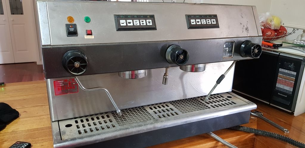

    G'day Joel...
    Welcome to CoffeeSnobs mate.
    That info you supplied is not a model number but rather the manufacturer.
    Could you possible take a photo of the machine and supply a link to it? Someone here will be able to identify it for you and get you started...

    started a topic Bezzera dal 1901 - trying to get it up and running!
    Hey guys, you will have to forgive my lack of knowledge, I'm new to this and don't know a lot of the lingo!
    I've come across an old bezzera, and wouldn't mind seeing if i can get it up and running as a spare for my partners coffee shop. It's been sitting in storage for a few years so I wasn't sure it would work. Anyway, I plugged it in, connected it to Mains and fired it up. Can hear water flowing into the machine, it lights up and then starts buzzing. None of the taps work, although I got a puff of steam out of 1 of the arms. After about a minute all the lights start flashing and it basically shuts down. Buzzing sound sounds sorta like a pump?
    Pump seems to be spinning ok from what i can see, I disconnected a few of the hoses and bits inside and theyre wet inside so doesn't seem to be too much of a blockage? Any ideas on where to start?
    I'm reasonably handy, can work most stuff out but I'm just not sure where to start!
