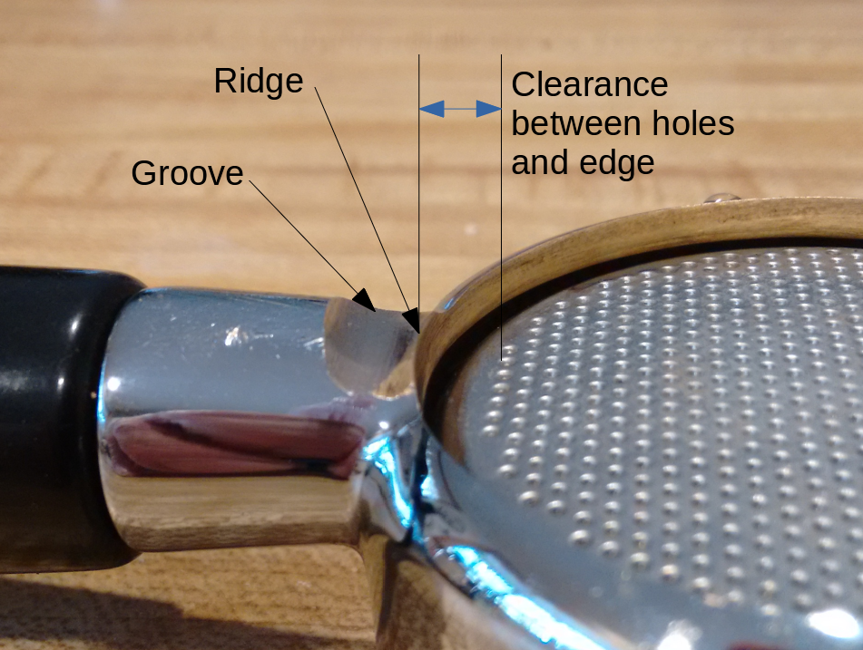

    Thanks Gonzo - what you've described is exactly the problem I'm having and thank you for the fix!

    I had the OP's problem too when I converted my La Pav pf into a bottomless one. The coffee would regularly run down the handle. What was happening was that the coffee was getting onto the outside rim when the coffee was foamy and it was then running around to where the handle was and then running down the handle (because the handle boss slopes down)
    I did the following:
    I cut out the opening on the pf so that the clearance between the opening and the basket holes was large (about 5mm)
    I orient the closest line of holes so that they are perpendicular to the handle
    I cut a groove in the handle so that a ridge was formed on the rim, making it difficult for the coffee to go up into the groove and then down the handle.
    This all makes sense from an engineering perspective, but every now and then I still get dribbles down the handle.
    The reason I like a naked pf is that I want the shot to be as hot as I can get it, and the standard pf is a lot of metal to suck heat out of the coffee.
    Gonzo
