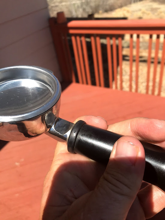

  • pcrussell50
    Whacked my -900 portafilter with a grinder. Five minute job (looks it though), hasn't leaked a drop in five years use in a -920 group:
    -Peter
