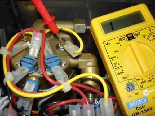

    Hi All,
    I took Miss Silvia on a family holdiay in January. She was doing great until the kettle and toaster were on at the same time and tripped the safety switch. Once the switch was reset, Little Miss slowly cooled down and wouldnt get hot again. I was hoping that it was just the safety thermostat that had come on, but when I opened her up the little red button hadnt popped out.
    Ive read quite a few forums to see if anyones had the same problem, and there are a few out there. Typically the problem seems to be the thermostats, which apparently you check with a multimeter. Im really hoping that it isnt the heating element, because that would be a bit pricey to fix. I did read somewhere that if the element is gone then white powdery stuff will come out with a blank shot.
    My multimeter off ebay arrived today, but Ive got no idea how to use it to check if the thermostats are ok. Ive done some googling, but to no avail. Can anyone help me please?

          Gday Adrian,
          I apologise if the following instructions sounds overly simplistic, but I dont know your level of sparky skills.
          Make sure that you disconnect the power cord before doing any of the following, no live testing.
          Set your mulitmeter to a low ohms range.
          Looking at the top of the boiler youll see the 2 thermostats at the front of the boiler. Remove the wires from one of the thermostats (spade connectors) and then put one of the multimeter probes on each of the lugs on the thermostat.  You should get a very low reading, nearly zero. Replace the wires and then repeat the process for the other thermostat. With both readings being nearly zero, you can rule the thermostats out. If the reading is 1 on either thermostat, ( I assume that you have a digital multimeter) this means that particular thermostat is cactus. If both are OK, then onto the next step.
          Youll see the heater element connections on either side at the top middle area of the boiler. Remove the connectors from the boiler and put the multimeter probes on each lug of the element. You should get a reading of about 50 ohms. Again, a reading of 1 this time indicates that the element is cactus.

                  I gather you tried to re-set the overheating switch (the little red one on the side of the boiler just under the left-hand thermostat).
                  But unfortunately, "1" means a break in the circuit -- in this case, the heating element.
                  But before you write it off, touch the two probes together to make sure you get a zero reading -- that shows the meter and setting is ok.

                              After doing some searching I can see that the whole boiler is going to have to be replaced. After about 2000 they started welding the heating element into the boiler (presumably to stop the common leaking problem). That will up the price a bit.
                              I checked 1st-line and they only have the 110v version ($86US). coffeeparts.com.au dont list it on their site (as far as I can see) but Ill e-mail them and see if they can get it.
                              Any tips on where I can buy a new boiler?
