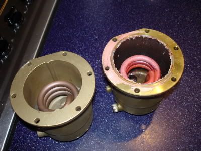

    Just a follow up to finish this thread.
    Silvia is now back in action. I was unable to source a boiler from overseas. After e-mailing at least 5 online stores, I only had replies from a couple. To be honest, I was surprised by the lack of response. Some seemingly large shops just didnt get back to me.
    So I ended up ordering the boiler from Moccopan. I got the old boiler out ok, but ran into problems getting the new one in. I didnt really have the right tools for the job, so I had to get them to put it back together for me. All up the cost was ~$270.
    Heres some pics I took when it was apart...
