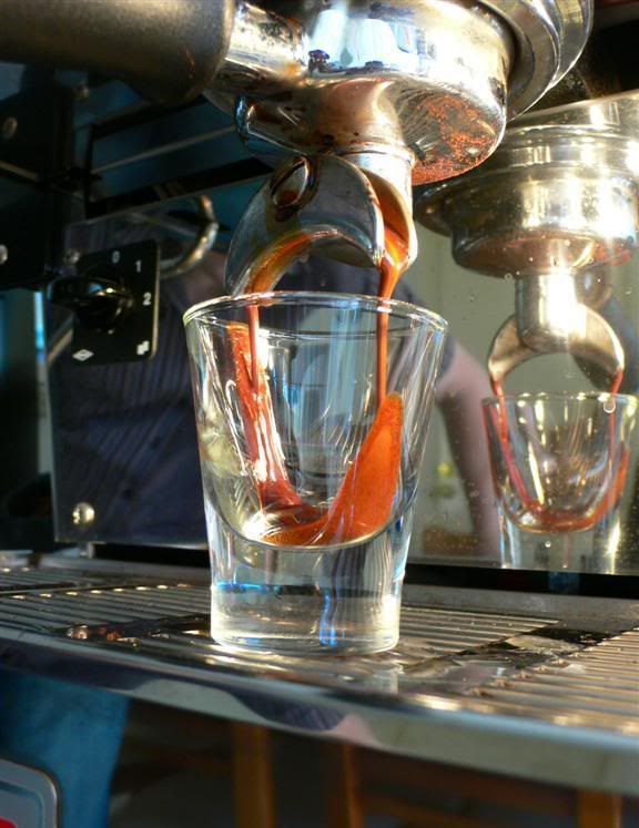

    That picture looks like Coreys souped up Linea with the 0.6mm flow restrictors. Ill have to investigate this mod as I find that the E61 preinfusion on my home machine is better than the shots from the stock standard Linea. Did Corey do the brew water pre-heat modification?
    Correct, it is Coreys home linea. As opposed to his shop linea. That guy has (had) too many lineas. I think that he just decided that he needed the one, two and three group ones. The four group is just two two groups in one body, so maybe thats why he didnt buy one of them, too ;P I dont think that Corey did the heating mods, but I might be wrong. Im pretty sure that he didnt have them at home, at least.
    We had a stock linea in Maling Room for a month or so while we were waiting for the Synesso. It had no restrictors and was not easy to work with. Dave did an experiment with his linea by putting a 0.6mm restrictor in one group, a 0.8mm in another and leaving the other without restrictors. He ended up switching them all to 0.6mms. I think that the shots with the gicleurs in them tend to be a bit more chocolatey and thick on account of the dwell time, but I think that they lose a little bit of the clarity of flavour ... just like on most e-61 machines that Ive used. If I had a linea Id probably put 0.6s or 0.8s in it. If you are going to order any, its worth gettin both and having a play to see which you prefer. Theyre only like $3 each or something. The 0.8s give you a few seconds less preinfusion.

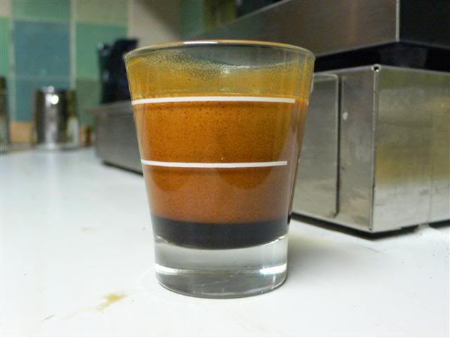

    Certainly, the better shots that I have had have changed pour colour and pour speed relatively little throughout the shot. Heres one of my favourite photos to demonstrate colour and unchanging speed:
    One would expect that starting off that fast the shot would have sped up massively and been too fast. In fact, it extracted maintaining that brick-red colour (similar in colour to the grounds) throughout. Of course, this shot was made for me on a hotrodded la marzocco linea, so it might be a little unrealistic to expect to get it at home

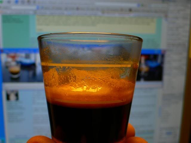

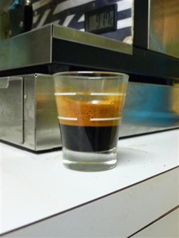

    One of the reasons why we need to measure at the top of the crema is that it can settle quite dramatically, especially if the coffee is too fresh:
    Straight out of the spouts
    A minute or two passes as I clean up
    I take my double upstairs and sit down in front of the computer
    This is probably why WBC competitors use coffee at a much later date than most of us do; I think that this years winners blend was 21 days old.
    Cant remember what the above shot was, but it was probably two days old or so and a single-origin espresso. For some reason, blends seem to have less volatile crema.
    Luca
