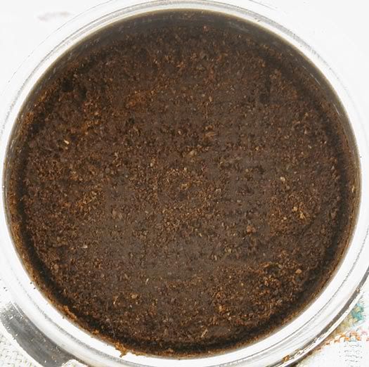

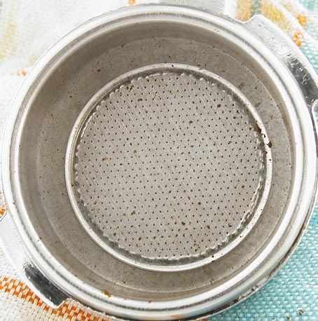

        Today I tried three dofferent settings on my MDF and did some pictures of the pucks. Its funny cause I used some beans roasted on the 27.11.06 and I had almost no crema:| Dont know why (well onlu around 0,5cm, although the Guiness effect appeared, and it looked really cool).
        So here we go:

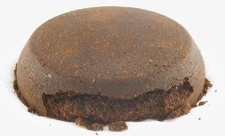

        1. Grinder setting: 3
        My Classic couldnt take it Nothing appeared in the first 20s, after that a few drops started coming out of the PF. Diagnose: too fine. But the puck looked good:
        although it got a bit broken when I tried to tap it out:
        maybe its because of some side channeling?

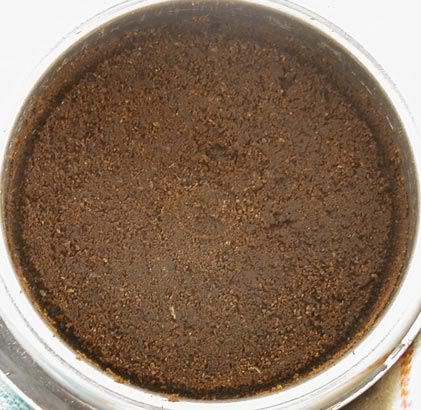

        2. Grinder setting: 4
        I guess I tamped a bit to hard, as the pour was quite slow, only 50ml in 25s. Heres a photo showing the small crema (its a one shot glass, around 25ml inside, the line shows 30ml):

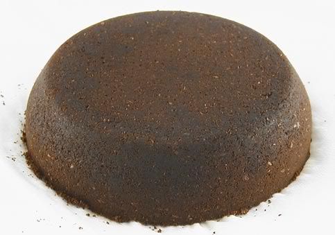

        The puck looked good, a slight shower impression:

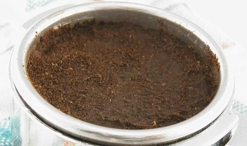

        and it came out easily:
        leaving an empty and almost clean basket:
        Decission: hmm tamped too hard, or grind still too fine, lets check out the 5th setting
        3. Grinder setting: 5
        A really fast pour, too fast I guess, got more than 30ml in 25s and virtually no crema. When I took the coffee cake from the basket it look quite nice, but the surface was covered in water and there was no shower impression:
        Decision: grind to coarse, going back to 4

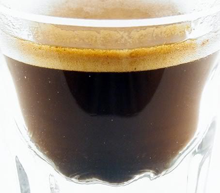

        4. Grinder setting: 4 again
        Tamped a bit lighter and it came out pretty nice, 30ml in 25s, cool guiness effect, although the crema died quickly again. I think it came out slightly too bitter. But I never tasted espresso, so I dont even know what it should taste like. Is it even possible to describe? What consistency should it have? Should it be really thick, or not so much? I noticed that the few drops that came out of the PF on the 3rd setting where very sour. I guess thats the first part of the pour right? After that comes the sweet stuff and at the end the bitter stuff? (Als rule of the three)
        On the 5th setting the coffee was really watery, but didnt taste bitter. 4th setting was more bitter, but also less watery.
        I will try to set up a video camera and maybe record my extraction, it would be easier to see what Im doing wrong
        Again thanks for all the tips and advice and take care,
        dsc.

              It appears youre using the single basket. Try using the double. Single baskets are notoriously hard to get consistant pours from.
              Java "Never uses a single" phile
              Toys! I must have new toys!!!

                    Gotta say that looks like a double puck to me. Im pretty sure the singles come in sharply, leaving more of a Taj Mahal profile
                    • #25
                      Re: Gaggia Classic begginer - extraction problems
                      Same here.
                      Puck and empty basket look like a double.
