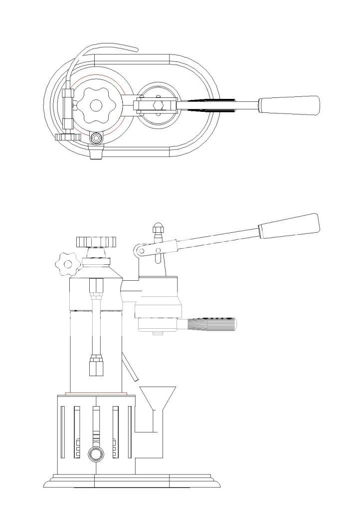

    The burner may be tiny but it is pretty fierce, I guess I wont really know until I have built a bottom for the boiler and had a test firing.
    The base is going to be cast aluminium, the final design is still to be determined, I may flare it out at the front to give some more lateral stability.
    I have almost finished the designs for the boiler base, I will post them here for comments once I do.

    Re: Frankenstein Pavoni project
    stability will be an issue- be sure to make the base broad enough to deal with it.
    Are you sure that little burner will be able to generate sufficient heat? The Pavoni boiler is quite heavy... It takes 5 minutes to heat a full boiler of cold water on maximum setting...

  • Aaron
    Thanks for the interest everyone.
    Here is the first couple of CAD drawings of the preliminary design.
    Lots more to come

  • Aaron
    Boiler temp will have to be controlled by adjusting the flame on the burner. I intend on mounting a pressure gauge onto the top of the site glass so I will have some idea of whats going on inside the boiler.
    The new base will be cast aluminium. I will post some preliminary design drawings soon. I have drawn everything up in CAD so I can work out the details before i get the dremmel in my hand.
