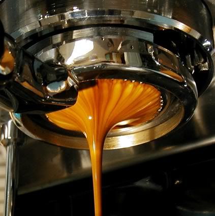

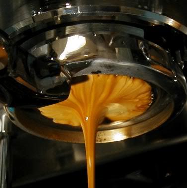

    So I decided to make a shot with my new equipment quickly. One thing I noticed is that the tamper is a bit smaller than the upper part of the basket. I mean it fits well inside the basket, but leaves a 1-1,5mm gap at the very top as the Gaggia double basket gets narrower near the bottom and are wider at the top. This is a bit annoying as it leaves a small ammount of coffee on the sides of the basket when tamping. Do you also have smth like this?
    I know theres a technique which uses two tamps, one light and one harder and a knock on the basket between those tamps to throw the coffee off of the sides of the basket. I heard that the knocking isnt the best idea as it disturbes the coffee puck and can make more damage than good. Maybe I should simply blow the coffee off from the basket sides after the first lighter tamp and not knock?
    After the tamping and making coffee I decided to use my new naked PF. I was a bit unsure if I should use it with my low level of experience, cause I heard it can be quite messy when the coffee is not distrubuted well. So I payed extra attention to that, tamped, crossed my fingers and hit the brew button...
    Fortunatelly it wasnt so bad was amazing to see it for the first time. I did it again with a different grind and took some shots:
    1. Ooops a slight malfunction:
    2. So now its a single stream, better
    3. Getting bigger:
    4. Blond! still too soon around 15-17s
    I really overdosed the PF this time. When I locked the NPF and unlocked it there was a slight impession of the shower screen (before the shot). I tried grinding finer but it was too fine, it dripped and gave only 20ml in 30s (went blond around the 22th second). I guess that middle setting on the MDF would work, I just have to find a way to keep that setting fixed without it changing during the grind.
    Im still working with one month old beans so premature blonding can be caused by it. I will try to order some fresh beans after Christmas and check how it works. Should I get pure arabica or a mix of arabica/robusta? I heard robusta gives more crema, but Im not 100% sure.
