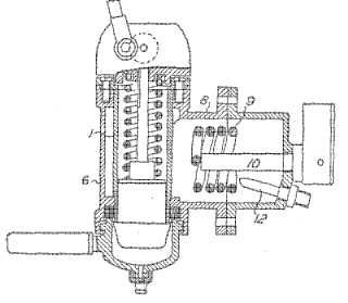

    It has thermal mass like an e61 but there is a larger distance for the heat to travel, in an e61 the thermosyphon water reaches the centre of the mass roughly, in a lever maybe it reaches the rear of the cylinder.
    For a double boiler lever it looks like gaggia figured it out 60 years ago but didnt do much with it, boiler volume wrapping the cylinder.
    http://worldwide.espacenet.com/publi...R=751687A&KC=A
