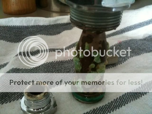

    Re: Importance of chrome on the e-61 mushroom
    Originally posted by 60626E6666686F72010 link=1284898281/0#0 date=1284898281
    Heres a before photo.
    That makes me feel so much better than I did when I saw Renzo remove the mushroom from my Expobar last year.
    Not important at all ACog. Just clean em up and youre one step closer to the shots
    Enjoy!
    Chris

    started a topic Importance of chrome on the e-61 mushroom
    Hi All,
    I picked up an early model two group Wega off ebay a couple of month ago. While I knew I was up for some work, well, lets just say I struggle to understand how it could get this bad.
    Im up to the challenge however, and have been busily removing various pipes and bits and pieces to get this thing operational again.
    Ive removed the E-61 mushrooms and they were so scaled up, I had to wrestle them out. After soaking in descale solution overnight, theyve come up ok, but the chrome plating has been completely removed.
    Can anyone tell me if the chrome serves a functional purpose? i.e. should I go get them re-chromed?
    Heres a before photo. Ill post up an after shot later on as I havent take one yet.
    -ACog
