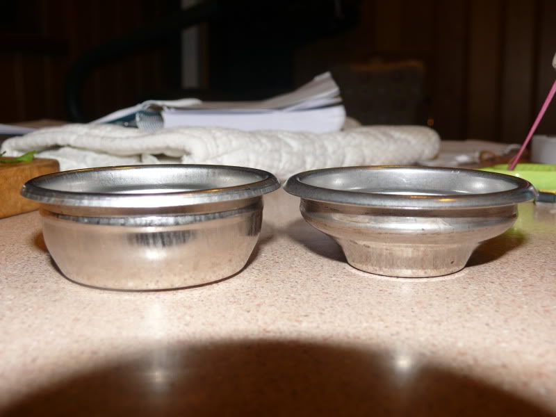

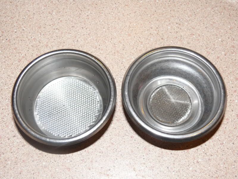

        Are your single baskets stepped, or do they just look like a flatter version of a double basket?
          Re: Doubles vs singles - not what people say...
          Single is tapered with a smaller outlet. Hence my suspicion that with an undersize tamper the flow is sneaking round the outer edge of the double.
