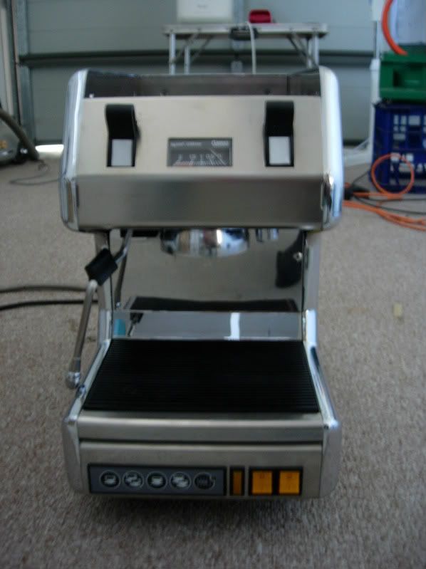

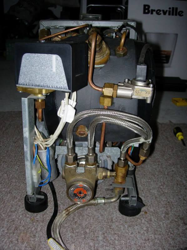

    The machine - crappy photos but it is a dark garage on a little point and click camera which couldnt handle all the bling with the flash, but couldnt get a crisp image with my handshake on a slow enough shutter to handle the dark light. Anyway, the blurred machine:

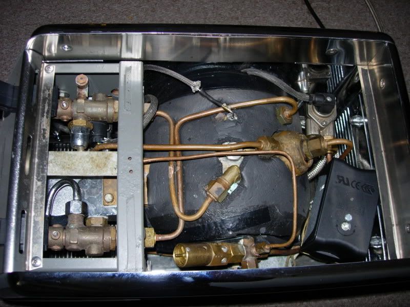

    Topless:

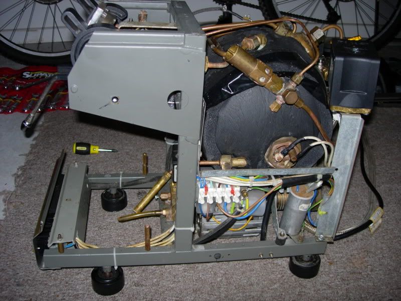

    Nude:

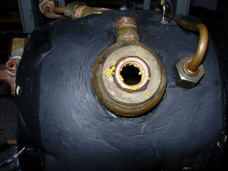

    HX piping removed. Does anyone know what that yellow crud on the thread is? Im assuming some form of thread sealant. It was a cross between rubbery and powdery and was on several threads. None of the threads had the crush washers or gaskets as per the exploded parts diagram - but I have a set of the washers and gaskets to put on during the rebuild. Im assuming with these, I dont need any thread sealant? Please correct me if Im wrong - Id rather not have to redo all the joints because of leaks - especially given Id then need to reco all the crush washers or buy more. Anyway, HX pipings removed:

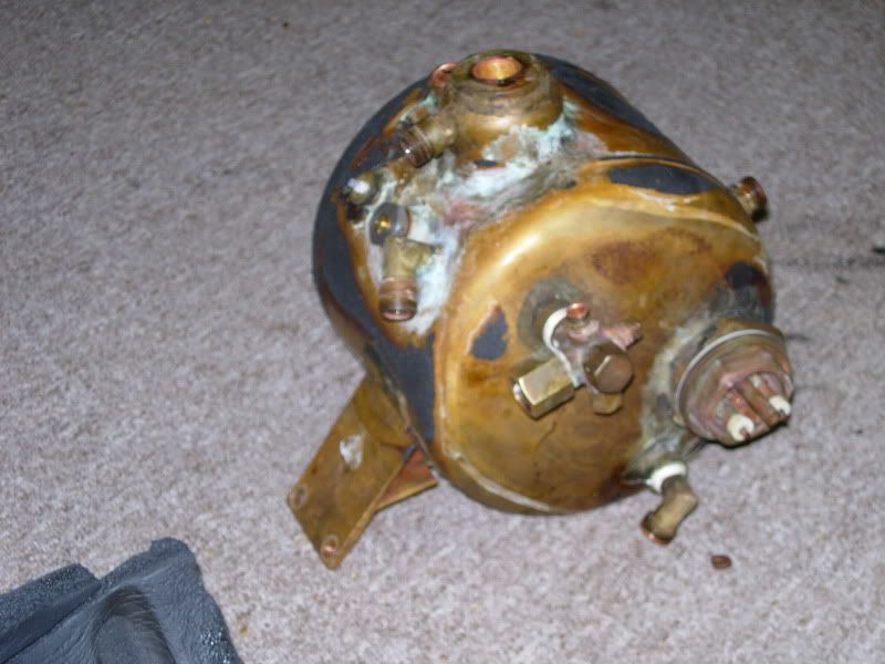

    Boiler out: (and I managed to not break any piping!  ) Looks pretty dirty on the outside. Some of the Armaflex insulation has stuck to the outside of the boiler  :-?. Should this happen? Has me in two minds about reusing it when rebuilding.

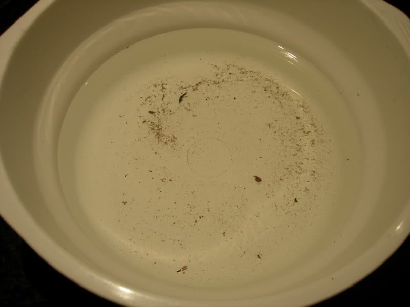

    Water from said boiler - not too bad, but this is after a lot of onboard cleaning earlier:

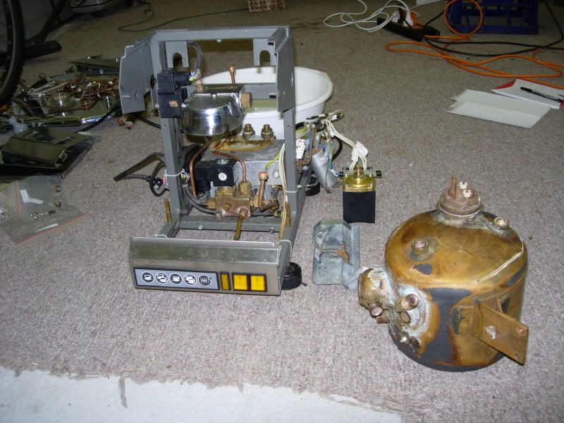

    Not much left to come off now:
    The group and wastewater paths came off the next morning but I didnt take any photos. The motor, pump and electronics are staying onboard as theyre all working fine - this rebuild is about cleaning rather than fixing.

    Im after some advice on the insulation. Given that armaflex stuff stuck to the boiler - should I reuse it? Should I buy something else like insulbrite? Or should I not bother insulating at all? It will be on duty in my kitchen for me - the sole coffee drinker in the house, and guests which would be less than once a week. On days where I just want to wake up, have a quick coffee and leave I will be using my Breville DB, but on days where Im home it will be the Carimali. Eventually the BDB will go to my workplace (but that will be another year before that will work out) and then the Carimali will be the workhorse of the house (and the occasional Pavoni when I want to play levers). What are your thoughts?

    I wouldnt use any thread tape or gasket sealant when you put the boiler back in, for the exact reason you found out. Little bits of it will drop into the boiler and end up heck knows where.
    As long as the threads and flanges of the pipes are in good condition (no pitting or scoring) everything should seal up no problem.

      That connection looks like it seals with a washer, hard to tell from the pics.
      I have seen recently a post where the CSer insulated the boiler with a rubber/silicone (orange coloured) material secured around the boiler.
