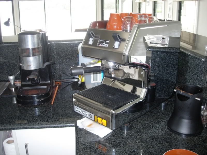

    Well, the final part of the journey is done - Ive plumbed her in. Although waste water is only plumbed down to a bucket under the bench - it was just too difficult to run a gravity fed waste water hose half way around my kitchen to where my sink is.
    Ive plumbed her through a Brita C150 filter and softener from Bombora. Thanks to Bernard who advised on the setup and sourced a couple of extra parts I needed for my setup. The C150 is brilliant. I mainly got it for the health of my machine but I immediately noticed the improvement in flavour from the filtered, softer water.
    So, the journey of the rebuild is complete and the journey of Carol serving me wonderful coffee is at the beginning of what will hopefully be a long journey. A small footprint, plumbed rotary HX is a joy to have on the bench. Very happy with the outcome.

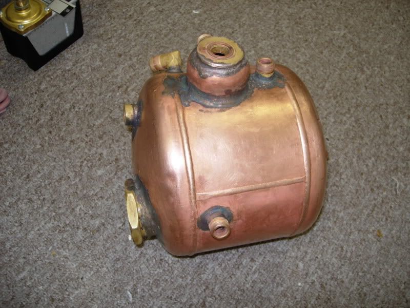

    Thanks. It came in fully working order, I didnt have to fix anything. However I believe it had milk taint in the boiler and thus the extent of my efforts. I think the onboard descale I originally did got rid of the tainted flavour in the cup but I was left with the thought of what it could be like in there and this pushed me into the strip down and clean. Im glad I did - its really cleaned up nice and left me with that absolute assurance that its all good inside.

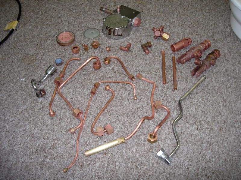

    I only needed to use some teflon tape on one thread. Everything else sealed up nicely. The one thread I did have to use tape on was strange - it is an elbow joint that screws into the boiler and has a pipe then screw into the other end. However when I did it up properly, it went about 30 degrees past where it needed to be for the pipe to meet up with it. When I backed it off that 30 degrees and did up the pipe, it would leak under pressure. So the only simple solution I could think of was some teflon tape for that joint. It worked a treat.
    All connections which come with washers or teflon gaskets got new ones during the rebuild. Everything is now sealed up nicely and working well. I have ordered my water filter and softener and parts to plumb it in today. So the project should be completed soon.

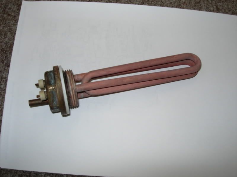

    nice one! your element efficiency is probably improved after descaling it too

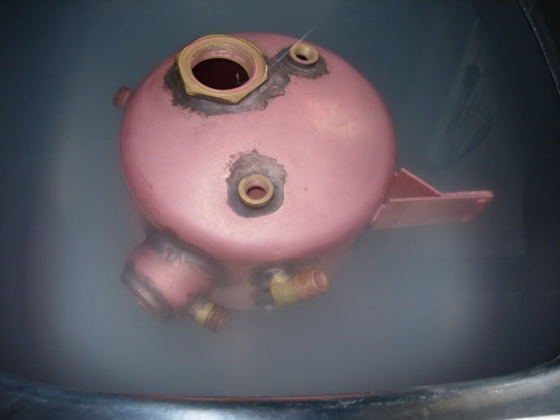

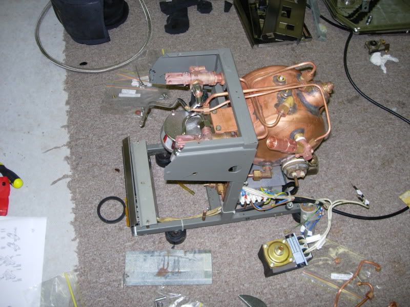

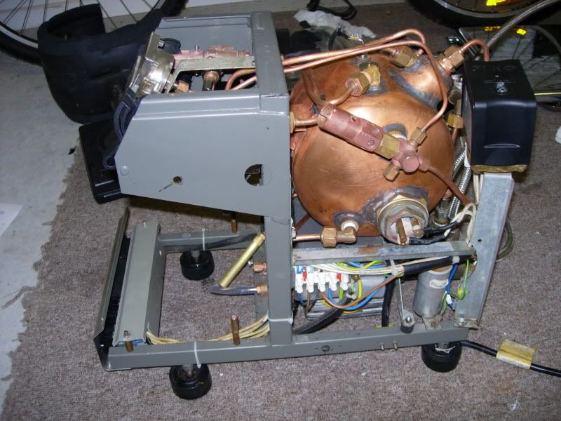

    Well, after only a couple of trying moments, shes done. Up and running, fully functional and a satisfaction guarantee that shes squeeky clean. Running like a dream too. I decided to go with not insulating her for now. She is off for about 2 min 10 sec and on for 7 sec. When she was insulated she was off for about 3 mins and on for 7 sec so I may still look into another insulation in future.
    Anyway, heres the rest of the story.
    Boiler in the bath:
    I also had several other buckets full of descaling baths with all the various pieces in.
    Element:
    The elements still underwent some gentle cleaning before going back in.
    The clean boiler waiting to go back on:
    Various bits and pieces laid out for the rebuild onto the chassis:
    I actually then changed out that jet for a Carimali spec .8mm jet before putting it together (a last minute decision).
    Coming together:
    All together now:
    It turns out I put those steam and hot water levers upside down - doh! :-[ Anway, that became obvious as I put the case on and was a 2 minute fix.
    From the side:
    The machine in place:
    Action shots:
    The result is amazing satisfaction in having done the job myself, getting to know my machine inside and out, being 100% satisfied as to its cleanliness and now pulling great shots of espresso from her.
    Now I just have to order my water filter and softener and plumb her in and Ill be done. Im stoked with the outcome and will only be more pleased once shes plumbed.
    Oh, and I think shes called Carol.

    Well, after getting paranoid that all the work could be in vain, I went for round two on the cleaning. Put the whole lot back into a descaling solution for another 48 hours and then into a bicarb soda solution for 24 hours with lots of rinsing in between and again at the end. I am sure it is all clean now. Everything came up nicely.
    I then blew some compressed air through the pipes and am in the process of rebuilding right now.
