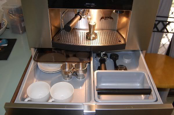

    The drawer works particularly well as it contains the knock box and some moulded holders to store portafilters etc.

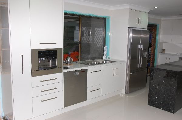

    Dont ask me why its taken so long, but finally I have this installed in our new kitchen.
    It is so nice to have a bench beside the machine to tamp the coffee on.
    Sorry about including the pic of a teapot on this forum!

    Anyway, just so everybody knows what we are talking about. Here it is in its makeshift home:
    And it rolls out to add water and beans
    And a drawer to keep everything tidy, I am sure I will have no chance of making decent coffee now...

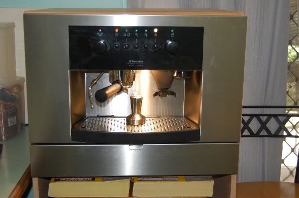

    Hi guys
    Hope you dont mind a bit of a story here... I decided to keep building on this thread...
    I purchased one of these last weekend as we are about to renovate our kitchen. Got it at well over half the original price (which means I paid about what it is worth for the Lelit internals it has). When I bought it, I knew nothing about espresso machines and the salesman was a bit of a CS and convinced me that I would make better coffe with a manual machine than a fully automatic one in the wall costing 3-4 times the price.
    Anyway, the journey started on Sunday as I toddled off to Bunnings and invested $31 in a sheet of MDF and with the help of a mate, built a temporary cabinet to fit it in so I could learn how to use it. Then I rushed off to a local Zaraffas outlet to grab some beans to give it a go.
    Tuesday I tracked down Veneziano on the way home from work and after sampling their coffee decided they would be my supplier. I grabbed a decent tamper and a milk jug from them and asked about their Barista courses. Before I knew it, I was back there last Thursday night with my new machine in the back of my ute to do a 3 hour course on how to make coffee which was run by Jai.
    After grinding about 750 grams of coffee, we concluded that there was no way that I could get the coffee fine enough. Jai said give it about 3 weeks and if I had not sorted it out perhaps it was time to consider investing in an external grinder which did not really make sense.
    You see the problem is that there is a stop that prevents the grinder being set fine enough as shown here:
    [img][/img]
    When I used some of the coffee ground on Venezianos commercial grinders, the perfomance was near perfect.
    So anyway, I lost a bit of sleep last night stressing about this and was geting a bit worried about fitting this slap bang where my wife wanted her new pantry and not ending up using it.
    I decided to go back to basics and after poring over the net, confirmed that this machine is indeed full of Lelit Combi hardware and was really pleased to see that on this forum they had a great reputation. I was gld to find I had not purchased a lemon!

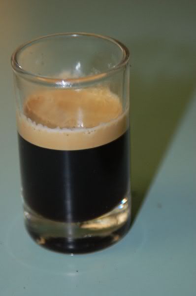

    Tonight, I to poured a single shot of 35ml in 25 seconds. It tasted pretty good, my wife was happy with the taste but I knew I can do better after doing Jais course.

    Anyway, I suspect the next mod might be to duck out to the shed again and turn up a replacement tamper to bolt back onto the machine in place of the undersized one. I have got some 60mm dia aluminium rod. Is there any reason not to use Aluminium as a tamper?

    the crema looks very pale. it could just be my computer screen. does anything improve if you make the grind finer? You also may have more luck with the double filter.
    I also agree with everyone else - get some good coffee first before trying too much or else you are wasting your time.
