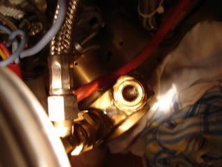

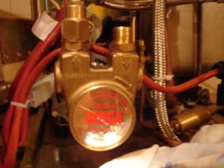

Hi guys, I finally plumbed in the Wega today, using a one-way valve (right way around!!,) 350kpa, filter etc. Problem is i think i have an air lock......Its not pushing water through the group or the water wand and the pump sounds a little funny.
The whole machine was working fine last week, i pulled some shots using an external water tank etc. After my problems today i hooked it back up to an external tank thinking that the pressure reducer could be too restrictive but it made no difference. Does anyone know how/if i can bleed this thing.
