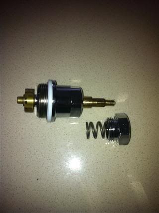

    After almost a couple of years the lever is starting to stiffen up and squeak again. Sort of sounds like a spring being pulled when I raise it to pull a shot. 2 weeks ago I pulled the assembly out as I did in the past and put some inox on it. Put it back together and problem solved. Today it started squeaking again. Pulled it out did the same thing, but still stiff. Not sure why? The only thing I can think of is that the descaling agent in my new water filter which I replaced around 2-3 weeks ago is to blame. Perhaps its eating away the inox. I decided to pull the assembly out and then crack the two sections apart with a couple of spanners. I havent done this in the past.
    After reviewing some older threads on e61 maintenance Im still not sure where to place the grease now thats its in 2. Do I need to go a step further and take more bits apart? I assume the roundish thing is the cam and the other end the "spindle"? Is the big thing in the middle the collar? If so, where the heck do you put the grease? All looks pretty sealed up to me...  Heres what the group looks like. I tried to dry things up a little thats why oils partially wiped off.

    Re: Squeaky and stiff Giotto lever
    Originally posted by 546365757E6F160 link=1236205891/54#54 date=1250036349
    I pulled chamber ("spindle"?) out as a single unit from group, applied INOX to the outside face of the roundish protruding collar thing-a-ma-bob and then reassembled.
    A cam lobe

    I ended up putting some INOX on my GPP lever assembly for the first time last night. Machine is only a few months old and I followed the same backwash procedure as that used on my old VBM Piccolo (never had to add lubricant) but lever started squeaking a couple of days ago and noise wasnt going away. Procedure seemed simple enough. I used the screwdriver to remove the lever handle, then the spanner to unscrew the outside nut. I pulled chamber ("spindle"?) out as a single unit from group, applied INOX to the outside face of the roundish protruding collar thing-a-ma-bob and then reassembled. Perhaps I missed something along the way as I didnt encounter any springs, etc. when I unscrewed the outside nut.  :-? However the machine worked perfectly this morning. Problem solved.
    My biggest worry was scaring/scratching the exterior of the parts with the screwdriver or spanner. I ended up wrapping the end of the tools with a little bit of soft tape so steel wasnt directly in contact with steel.
