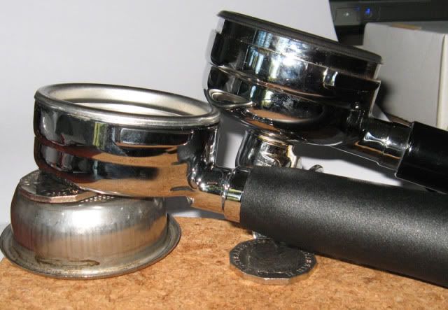

                      Re: Coming to terms with the witch: strega
                      Ok Ive now done a test and some measurements ... isnt science wonderful? - and it transpires we need to be careful about making general rules, as baskets aint baskets ...
                      Synesso on the left, Bezzera on the right. The Synesso is 2.5mm deeper but probably in practice there is a greater difference because of the Bezzeras larger rounded rim and also because it is ridged and that ridge extends into the interior of the basket, so I imagine youd want to tamp below that? I must admit i dont like ridged baskets generally, so even though my tamper seems to fit this one ok, I much prefer the Synesso.
                      What I did find after making a shot with the Bezzera basket is that if I was using it, I would need to reduce the dose AND grind quite a bit finer - which I put down to the Synesso having more, but smaller holes.
                      HTH you a bit Tony, and before you ask, I am very much on the learning with a quality machine curve myself, so dont treat anything I say as gospel, ok?
                      BTW I think Jim did say somewhere that the Strega was more than usually basket sensitive (he didnt think it worked at all well with VSTs), so it may pay to experiment. I have both a Synesso triple and a bottomless pf on the way, so I may have more to report ... and show ... hopefully soon.
