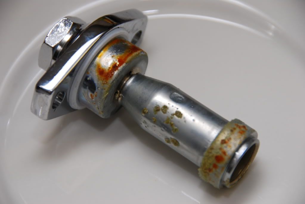

    Hi all,
    Just got hold of my first E-61 machine. Its a used Vibiemme Domobar Super approx 6 years old. Not yet been serviced or descaled. I took out the mushroom and just wanted any opinions on the degree of scale.

    Re: How bad is this scale? Vibiemme Domobar Super
    very minor buildup
      That is nothing really. Acid dip in citric acid for an hour or so and it will remove it without any problems. Use weak acid, 1 tbsp per quart of hot water. If that is in fact hard water, youll be able to wipe it off after and everything will come off :]
        Pretzal was this machine bought in Adelaide? If so they either had a good filtration unit or hardly used the machine. If you use non-softened Adelaide water youd get worse scale than that in 3 months.
            The machine was purchased in Melb and brought back by my cousin who was moving across. Had been used at their holiday house (dont know where). Supposedly it hadnt had much use. Given they didnt know much about it and it wasnt that clean on the outside Im inclined to believe it. Seems like a good machine and it shines real bright! I actually like this model aesthetically more than the current model so I guess thats good for me.
              Personally I wouldnt bother. The more important question is what sort of water are you using now that the machine is living in Adelailde.
                  Hi Pretzal,
                  Nice pickup. It looks to be in terrific condition.
                  I definitely wouldnt descale at this point and would never use citric acid in any machine. You will find the C150 will do a terrific job. It looks more like a little salt corrosion than anything else. Its always hard to pick in a photo though.
                  Do check every so often for scale and change the filters as required. You can only ever slow scale buildup.
                    Thanks Chris for the comments. Glad to hear you recommend I dont descale it - didnt really want to do it anyway ;D
                    Ill have to check the bypass out - I dont recall any mention of it, nor have I even noticed it myself. Ill definitely change the filter once its time has expired - cheaper than the alternative
