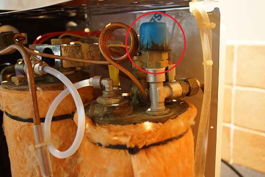

    When the problem started happening for me it went back to a service agent (in Dandenong, Vic). They replaced the valve with an updated design, probably what is in the Minore 4.
    It didnt fix the problem though, the thing still spat water everywhere.
    Glenn, if you are sensible and careful, pull the side cover off (two screws on each side and one at the back). Then keeping well clear, turn the machine on from a cold start and watch in the area above the boilers, after a few minutes you will see some water start to spit out. Some is normal, lots causes the breaker to trip.
    My fix (which isnt ideal) was to cover the valve, but not block it. The blue thing you see in the picture (my fix) doesnt stop the water coming out, but it does stop it spurting too far (on to the wiring). Its just a plastic cap with a 6mm hole in the top.
    Its a crap design from factory IMHO, there should be a small tube for the water to travel down, or, a cover of some sort. There is wiring just centimetres from where this valve is.
    Hope that helps.
    Ross

    Had this very problem on our Minore III when it was a 3 or 4 months old.
    Do you find this only happens during the warm up period when first turned on in the morning? This is when ours was tripping the breaker, almost everyday in the end.
    So, I found the cause, there is a little valve on top of one of the boilers that is supposed to shut as the boiler comes up to temp. The problem is these spit water everywhere until they shut. There is no fix from Expobar, I did a temporary fix that has been permanent for about 2 years now  :
    Its nothing to do with overcurrent, we can have the coffee machine and kettle going at the same time, its the water going everywhere inside the machine that is the problem.
    If this sounds like your problem then Ill take a photo of what I did, its really easy. You will have to pull the side off the machine so check with the shop first to see if they are ok with that.
