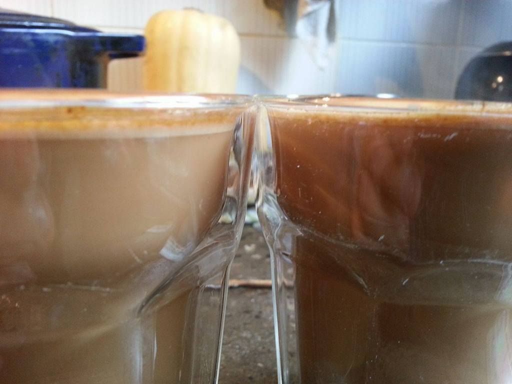

                          • Machine seems to be getting worse
                            this setting
                            produced these

                              Those photos are fairly indistinct.Maybe a view from above as well ?
                              Edit : just saw you did try the manual and auto froth in water trick. Appears you have exactly the problem I had with my first machine....air pump not working .Ring the Oracle number and they will give you a number to take to your supplier for a swap .
