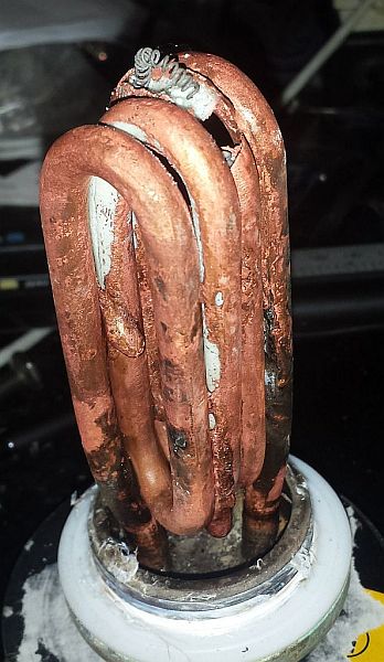

    Shortly after putting it back into service (the day after IIRC) the RCBO was tripping again, so the Zaffiro has been sitting on the coffee bench since.
    I finally found some time to get back to the Domobar Junior, powered it up in the garage (on my nice, shiny new, properly designed and installed electrical plant) and it instantly tripped the circuit's RCBO (not unexpected), disconnected the element and tried again, no surprise at all when the machine powered up without issue, so evidently it's the element that is the problem.
    Pulled the boiler to extract the element, after some exertion and a bit of swearing I cracked the element loose, and this is what I found;
    So it appears that during the controller fault the element was running uncovered for quite a while, yes those are blobs of melted copper.
    Possibly a one-two punch combo between the faulty anti-vac valve preventing the boiler from sealing (preventing the pstat from doing its job, and also providing an exit path for water vapour) and the controller running the element inappropriately which allowed the boiler to boil dry (checked the water level probe, it's well above the top of the element).
    Strange that there was a delay before it started tripping, all I can think is that it took a while for the moisture to get through the ceramic core of the element.
    New element and gasket en route from Coffee Parts, once they arrive I'll put it back together and then it should finally be able to take its rightful place on my coffee bench.
