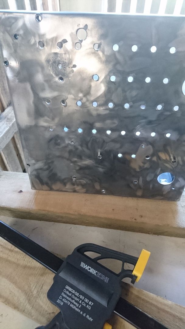

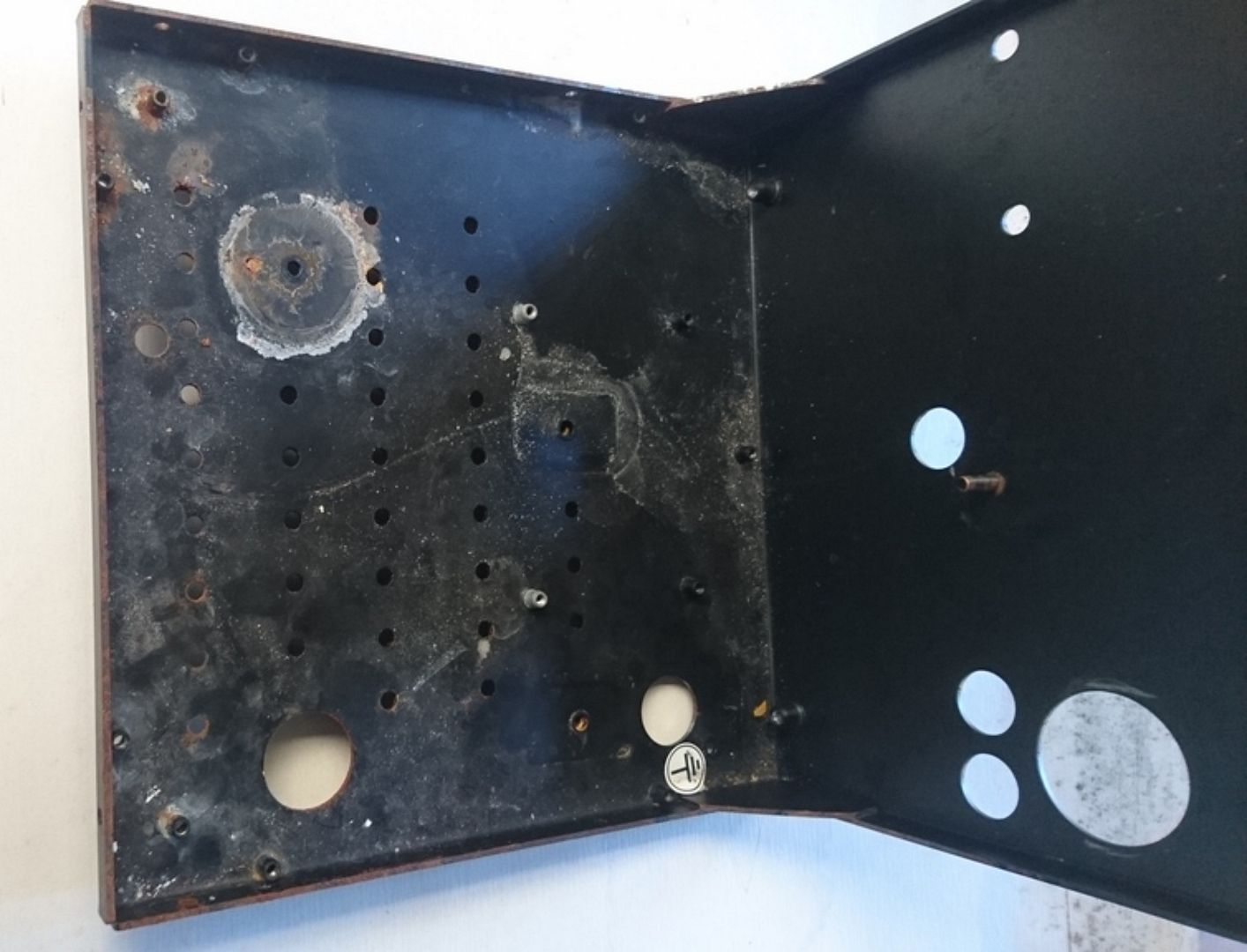

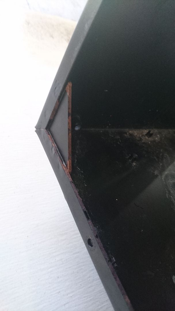

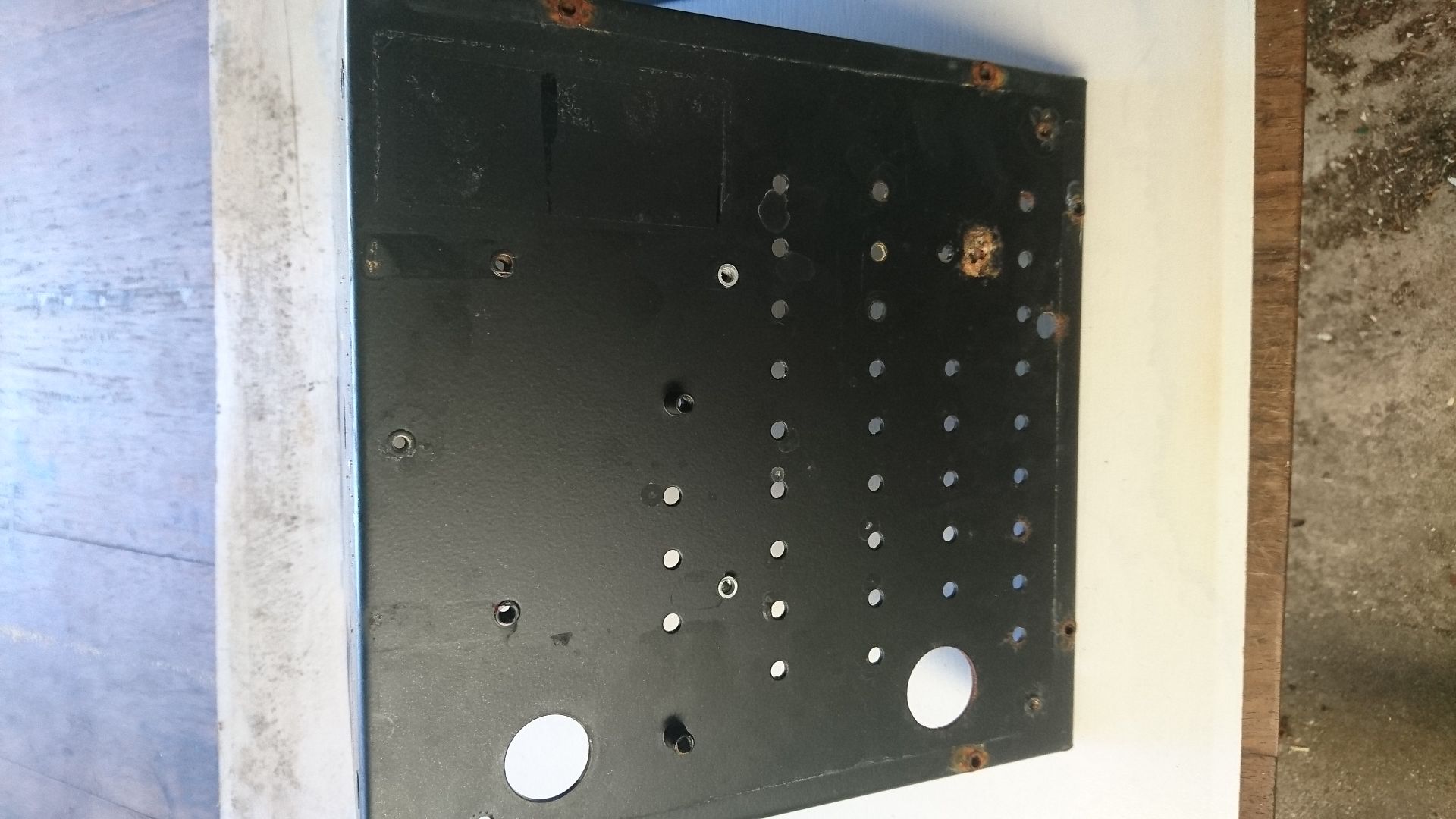

          So I have totally taken the machine apart and there is a bit of damage to the chassis. I got a quote for powder coating but it was bit more than I was currently willing to spend so I had a crack at doing it myself. Make sure you wear a dust mask as it makes a mess and gets everywhere.
          Main Chassis
          Underneath
          Stiffener
          Behind the front stainless panel
          After stripping the paint, you can see some corrosion damage, this is under the water tank receptacle. All other corrosion was superficial.

                    To be fair, the quote I got was $120+ GST. Which I wouldn't consider excessive if you have something you really want to protect. If you do the sand blasting yourself you might save some more if they let you.
                    I paid about $10 for the wire cup and $17 for the paint. If was doing a proper job I would have use a high build zinc rich primer, but in reality, it is not a very tough environment, so as long as the paint sticks, it should be good. I did sikaflex the stiffener joins, as I think that is the only place corrosion could do some proper damage.
