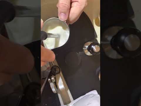

  • alexcs
    Originally posted by west912 View Post
    No pressure, but still waiting on the steaming vid......(see what i did there...no pressure...) Ok I will crawl back under my rock.
    In all seriousness I would love to see you roll some milk. I did come across a video of an asian retailer demoing the machine and did 2 steaming sessions at different boiler temperatures, but without knowing the language I could not follow his commentary. The higher temp frothing seemed impressive.
    Sorry for the long delay, I finally got a passable video of the steaming ability:
