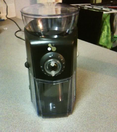

    Re: New to the grinder world, is Aldi a dirty word ?
    Alright,
    after one night of using the grinder, to sum it up in one word: Crap.
    Sum-up in 10 words: Better than stale pre-ground coffee for pressurized portafilters and stovetops.
    Please keep in mind that this is a $30 grinder, and I have only used it for making coffee with a Sunbeam Cafe Espresso (EM3600) with a pressurized portafilter - Right near the bottom end of the espresso machine market. All up you could get this "set-up" for less than $200. Also, though I dream of being a super-barista and I have been learning lots from this site over the last 6 months, I still have a very limited knowledge on coffee things, particularly grinders.
    The coffee had been roasted in the last week at the local roaster (So lucky to have one of them!). Its Ethiopian/Bolivian Fairtrade and smells fantastic!
    Photos!
    this second one shows the grinder without the collector box. You can see the spout coming out horizontally.
    The first thing I did was grind a small amount of beans on the coarsest and finest setting. Coarsest setting was very inconsistent with large chunks and fine particles mixed through - quite inconsistent. The finest setting removes a lot of the larger chunks but you still get an inconsistent grind, and its nowhere near fine enough for a good espresso machine.
    Made a couple of lattes and they tasted much better than coffee that was ground a week ago when I bought it. Its not as good as finely ground, fresh coffee, but its better than finely ground, stale coffee. It would probably be good for stovetop and plunger (french press) brewing methods.
    So here are a list of pros & Cons.
    Pros:
    - $30 conical flat burr grinder
    - 60 money back guarantee - if you hate it just take it back
    - 2 year warranty.
    Cons:
    - All plastic construction, except for burrs and screws (and motor)
    - Burrs are tiny and not sharp at all.
    - Timer is a gimmick. You have to have it on to use the grinder - can be annoying.
    - STATIC galore. I have never seen so much coffee in an upside-down container. Also, to get it into your portafilter you need one big bang into a funnel or lots (and lots) of little taps to encourage to come out of the plastic collector box. Can be very messy if they decide to go all at once.
    - The spout into the collector is horizontal and a soft rubber. One use and it was covered in grinds that you cant remove. It also flings the ground coffee straight into the wall of the collector box, so no chance of dosing directly into your portafilter.
    - If you dont have the hopper lid on rogue beans shoot (at a decent speed!) out of the hopper to about eye level. I didnt cop one to the eye but I can see it happening!
    FINAL THOUGHTS
    I reckon that for $30 it is better than pre ground coffee for anyone who has a lower end machine like mine, or a stovetop or plunger (french press). It gives you fresher coffee, and for these types of brewing methods this grinder can give a suitable grind. No go for any espresso machines with un-pressurized baskets, as the grind is no where near fine enough.
    I havent tried it with a stovetop (or aeropress or anything other than the above machine) but if I get the chance I will post up my thoughts.

    Burr housing is all plastic, lugs and lock mechanism look dodgy, burrs are tiny and look soft. The timer is twee.
    You get what you pay for, but any grinder is better than none which makes it great value!
