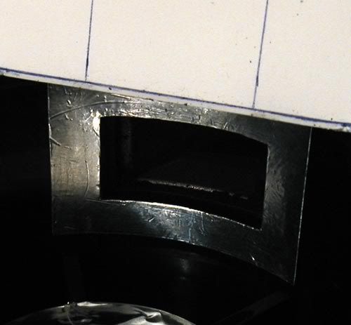

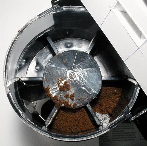

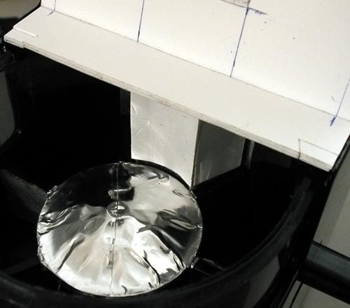

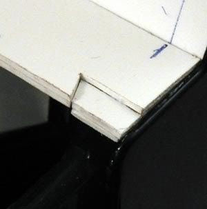

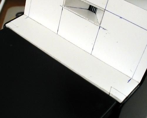

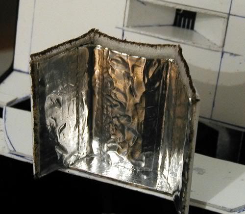

            Below you will find some photos of my last mod. As I said in my earlier post I had to change the outlet cover and add a small plastic plate above it, to prevent coffee from falling inside the machine. Now it looks like this:
            1. from the outside with the doser cover on:
            2. doser cover removed, you can see the outlet cover:
            3. but what is this? oh a small button to remove the outlet cover it holds the cover in place during the grind
            4. here you can see foam curtains I added to keep the coffee falling right between the doser arms
            5. and the outlet itself, covered with some aluminium foil to minimize the ammount of coffee sticking to the sides
