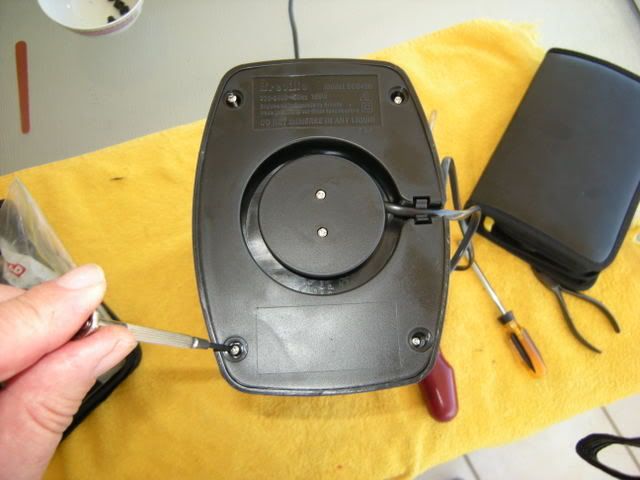

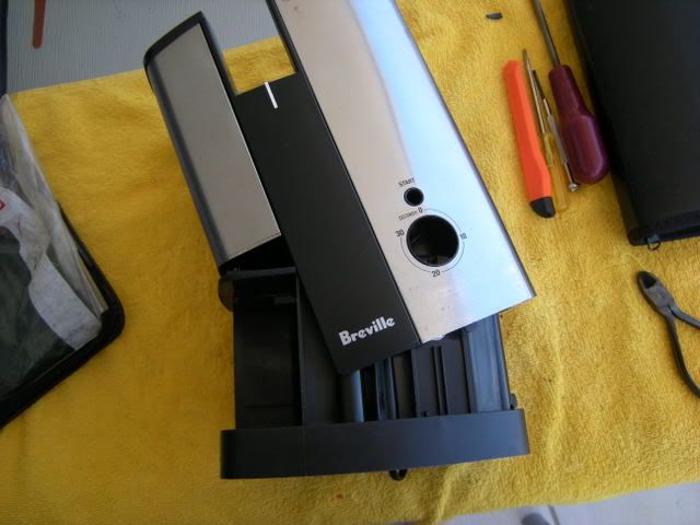

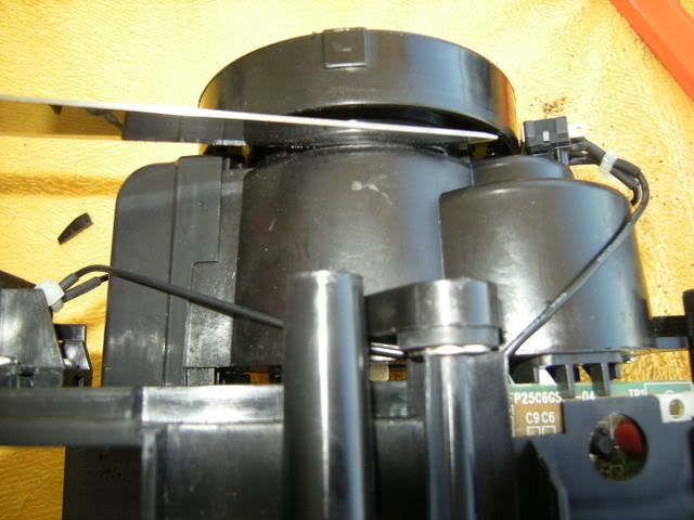

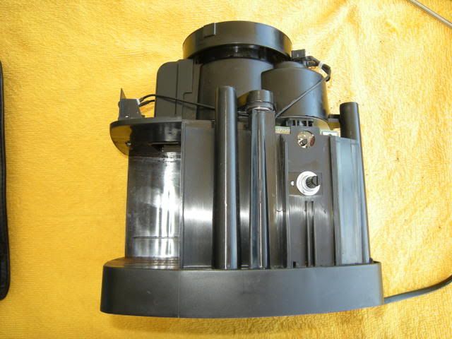

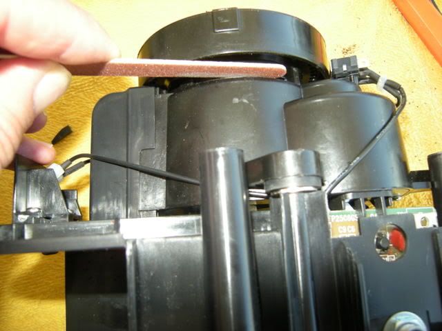

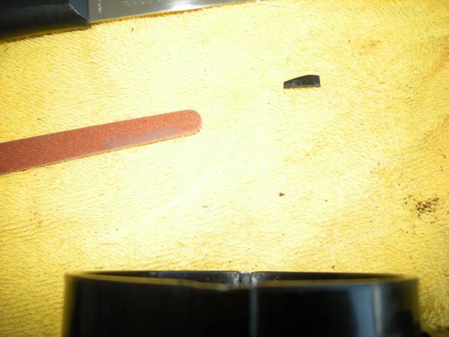

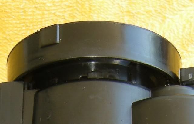

Bit of a search on google and I find a blog with a mod for the BCG450 ( Ive attached a PDF of it). Seems theres a small plastic stop which is like a premature stop for the burr clearance. just past it is the real stop. Heaven know why breville put it there but once it is cut off you can turn the hopper a good inch and a half past Turkish. Not that you need to, two more clicks past the "Old" stop and it produces the nicest, most even and fine grind Ive seen from any grinder!
So, for $59 Ive now got an awesome little grinder producing a grind as good as my combi or the sunbeam!
One tip though, to remove the stop just cut carefully with a junior hacksaw or similar and dont remove the ring as the article suggests is an option....mine looked decidedly un-removeable!
