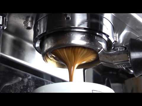

                            • I received my shim kit a few days ago. I initially installed the recommended shims (1x1mm + 1x0.4mm), but eventually had to add another 0.4mm shim, which now seems to have given me plenty of adjustment. I still have one more shim, but doubt it will be required...
                              In the past, I've been unable to get a slow-enough pour from the Gaggia classic with an 18g VST basket (or any basket, really), as the grinder out-of-the-box was not grinding fine enough. This was obvious with a recently acquired bottomless portafilter. Ugly looking pour. To get a half-decent result, I had to over-dose the basket (up to 21g at last count), but I think this may have been contributing to a terribly uneven pour (always left, which seems to be a common Gaggia complaint on a number of forums). I thought this might have been part of a faulty design on Gaggia's behalf (as, under the shower screen, the water generates from the left), but wondered whether coffee touching the shower screen before hitting the brew switch was causing this. And frankly, I've seen some spectacular looking pours from Gaggia's on youtube such as this one (not mine, sadly):
                              After adjusting the grinder, it seems my suspicions was correct.
                              I just had a lovely 22 sec pour with 18g of coffee in the basket, and a perfectly central pour!
                              I now have lots more adjustment to the finer side (I'm just past the "O" in espresso), so I will continue to grind a little finer, as it blonded a little early, but I have little doubt that I now have the ability to choke the machine at will.
                              As an aside, after fitting the shims and adjusting the dial to grind finer (whilst running the machine), I was a little disconcerted by the apparent slowing of the motor, as if the grinder was under load. To my ears, not the sound of metal-on-metal, but it made me a little nervous. It is completely unnoticeable when beans are in the grinder, however, and a quick search suggest others have had a similar experience.
                              Hopefully this post is of use to both Smart Grinder owners and Gaggia Classic owners who are pouring to the left!
                              Andrew
