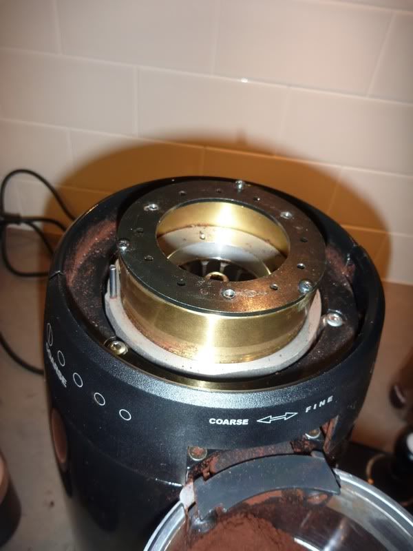

    Re: Compak K10 Issue since service - Assistance appreciated
    That worked great. Thanks The Espresso School greatly appreciated.
    If your grinder is stuck simply re-zero it.
    Unwind the burr carrier (clockwise).
    Vacuum out debris and clean burrs.
    Wind burr carrier (counter-clockwise) all the way down until burr touches burr.
    Unwind by half a full rotation.
    Dial in grinder from this setting.
    Thanks for the feedback. I ended up cleaning it with many many pieces of power towel and now is is turning smoothly.
    My issue now is that the collar is wound back down into place the finest setting is quite course. Ive obviously done something wrong when screwing it back down or cleaning the collar.
    Im sure its an obvious thing. Anyone know off the top of the head what I may have done wrong?
    Hello Jason,
    Your grinder was returned set to approximate espresso grind. You will need to adjust your grind according to your coffee and your technique.
    As to the collar, you will note that there are 3 metric screws and in fact the collar can go on any way you like, so long as the stop functions appropriately. If you have a favourite position, bring it in and Ill face it whichever way you like.
    The collar will be fairly tight as its impossible not to get some debris in the thread when its dismantled. An hour was spent removing as much as humanly possible. It will improve in time.
    Finally, a reminder that grind is a fluid thing, not fixed.  You do need to make grind adjustments in response to a whole host of factors.
    Chris

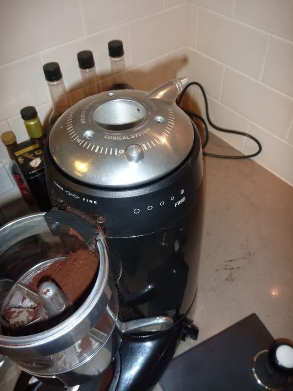

    started a topic Compak K10 Issue since service - Assistance appreciated
    Hi All,
    Sorry to bother you but I just got my grind and espresso machine serviced today and upon receiving the grinder back Ive found that the Grind plate/\/regulator was pointing towards the back rather than out the front as it had previously been.
    This lead me to believe perhaps it was an oversight by the technician and put on back wards but upon removing the plate it appears I cannot get the grind to change no matter what.
    Ive gone through the manual a few times now and cannot seem to grasp whats wrong. Ive attached two photos below with hopes that may help this community in hopefully identifying the issue.
    Any help would be appreciated and I thankyou for taking the time to read this.
    - Jason
    im unable to change the grind setting.
