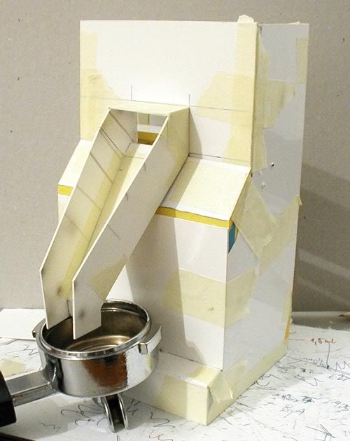

    Heres a small update:
    Looks like an elephant doesnt it?
    Yeah I will add ventilation holes and make sure nothing overheats. In fact I already have a forkless base that I use now, might as well use it on the new case
    So everything is PCV now, all I have to do is sand the edges, glue it together and see how it works.
    Youve definitely got me thinking of ways to make mine dosserless now
    Yes yes mod it!! the dark force is strong
    dsc.

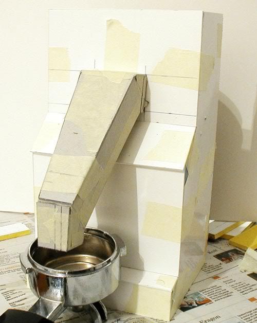

    Ive got a small update. Ive tested the new cardboard shoot and it works good, the coffee slides down into to the PF and there are almost no clumps. Below you can see how the plastic case looks like. I know its not pretty and it looks like an elephant or some wierd alien machine, but it should work Im wondering if I went to far in the whole "mod anything you can" extravaganza.
    dsc.

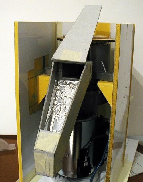

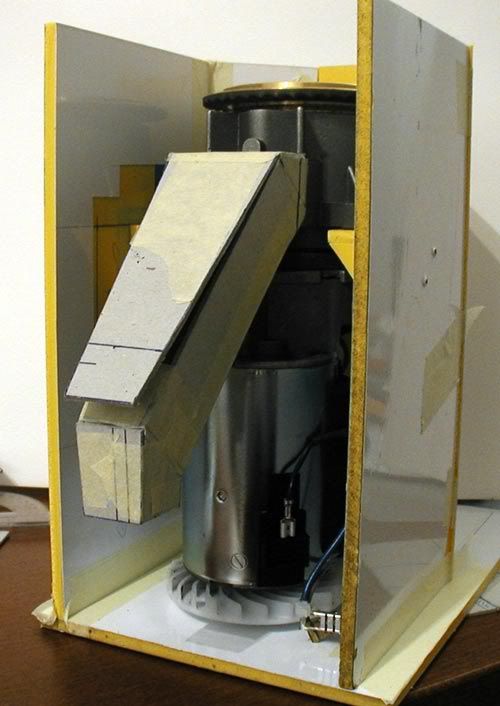

    The MDF is pretty good at getting clumpless grinds, although the doser makes quite a mess on the counter. I mean its all good when the basket is empty, but when it fills, the coffee coming from the doser hits the surface and smashes making a mess, is this normal? Its also annoying to keep hitting that doser arm all the time. Im going to try out the new case (with parts temporarly in place) and see if it clumps a lot. In case it does, its back to the old case, if not I will work on it some more.
    Anyway here are two photos with the grinder inside the new case:
    It has a temporary cardboard outlet which can be opened to clean out the grinders inside outlet. I will test it soon.
    dsc.

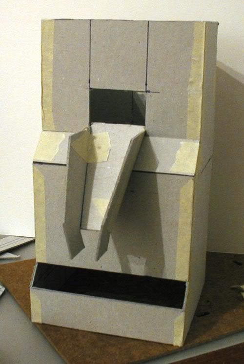

    Im planning to turn my MDF into a doserless grinder. The doser drives me crazy and Im already using a WDT distribution to break the clumps, so I can remove it. I tried to modify the case of the grinder after removing the doser, but its not possible without cutting out big chunks of plastic. So what do you do in a situation like that? Build your own case!! ;D
    Below you can see a simple cardboard mockup model:
    All I need to do is build an exact thing from 0,5cm PCV and add three screw holes inside to fit the motor and the grinder. More photos to come soon.
